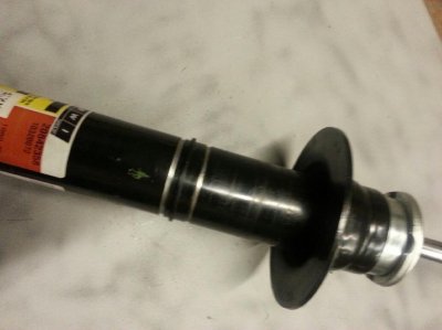

Been doing this for over 6 years now on the 07 up trucks (aug 2006 did the first one and customer still has the truck with no issues)
I have a machine shop I do stuff out of so you will need a machine shop to do this. You remove the spring assembly and you pull up the lower spring perch and you will actaully do 2 grooves. The top groove is the factory one. The middle one is put at .40 under the oem ring. Then the 3rd one is .620 from original snap ring groove.
I was at 34 3/4 from ground to fenderlip on 305 30 24s and belltech spindles on my 2011 escalade. Going .40 under the original groove I am now at 34 1/8 which was 5/8 of a inch drop. THe .62 should give you about 1 inch drop.
Also remember to cut the front bumpstops down when you do this mod.
I charge $25 dollars per strut to do this mod for one groove ($50 a set) If you want additional groove add $10
I can do grooves from 0-2 inches but if you want multiple grooves I have to have at least 1/4 inch between grooves.

autoride or non autoride doesnt matter.

1" of drop in the front killed my shock. The shock could have been going anyway, but I'm inclined to think this mod hurts the shocks prematurely.
Obviously, this hasn't been and won't be the case for everyone. I know folks are running an inch of strut relocator drop without issues. I didn't have success with it, though.

Yeah yours was weird. So far on the ones ive done 1 inch or less has been no issues plus mine went down like 5/8 of a inch more which isnt that much but just set the truck perfect on my escalade.

add another shock to the mix to get done BE GONE GM LEAN lol Ill try to get to the machine shop tonight if i can I need to finish this trailblazer ss first.

What size tire?
My escalade sat high from factory on 285 45 22 was 36.75 :(
With spindles and my strut mod for about 2.75 in front im at 33 7/8 with 305 35 24.

just finished machining it. yet another norcal modded strut is let loose to the owner to get rid of the gm lean lol
