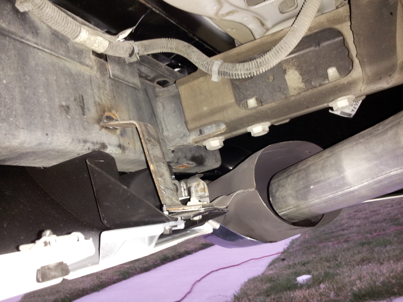

I'm not trying to bash or prevent business, but to do it right it is not a 15 minute job. Yes taking the bumper cover off is 15 minutes but in order for the new one to even mount on you have to grind off the 2 lower metal bumper bolt brackets and sawzall off the stock resonator or else the new bumper won't even bolt on. Once you have those cut / ground off you then have to have the brackets re-welded to the metal bumper bracket if you want to re-bolt the bumper cover to the metal bumper frame, which is a MUST or else it will be too flimsy.
Just figure that is good info for this thread. Again not to deter, but members need to know exactly what has to be done before they get stuck in their garage/driveway with no way to put the new bumper on.
"custom" lower bumper brackets
custom ran straight exhaust (no resonator or spare tire)

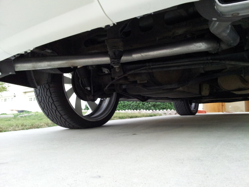

I currently have SLP tips/resonator delete, so the resonator isn't an issue. So basically if I order the kit all I have to do is;
1) Remove the old bumper (15-30 minutes)
2) Remove and reposition/weld bumper brackets to hold new bumper (15-30 minutes?)
3) Install new bumper (15-30 minutes)
4) Y pipe exhaust after the muffler and route accordingly
Seems pretty simple - I have a friend with a lift and he can do exhaust work as well. The only other issue I see is how do you hang the pipe coming out of the left side of the truck? The right side has a hanger from the original exhaust but what do you do with the other.
Thanks for the help guys I really appreciate it.

No spare tire Lee.
And you don't have to weld anything. Just unbolt and bolt back on. There are two tabs under the bumper with 10mm bolts. Those tabs are the only thing you would have to relocate, but it's not necessary to have the bumper on. Just gives it more support on the bottom.

You just add another hanger off the left side frame rail. One per side is plenty.

IMHO, for what it's worth, there is no way I would run this bumper without those two lower mounts relocated and bolted down. Those 2 bolts are the only thing holding the cover down on the bottom side. The cheap plastic clips / 6/7mm bolts holding it up top doesn't seem sufficient, especially at highway speeds with the wind blowing freely through the spare tire area and constantly putting strain and pressure on the lower bumper cover.
