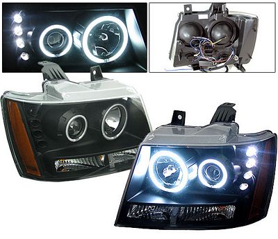

Aftermarket 'Projector' Housings (ebay specials)
So you like a little rice with that truck, and think that an aftermarket projector housing (Spyder/Depo/etc) will set that off for you?
You use the google and come across something that looks similar to this:
Not only does that look spiffy, but the description includes the word projector.
Not only that, but some vendors are super enough to attach an HID kit to them.
Problem solved, I have pwnd stupid GM and their stupid halogens and got myself them cool HIDs.
Actually no.
What you got there is pieces of shit.
picture.php
NONE, and I really mean NONE of these so called projectors are meant for HID bulbs, and few if any have any of the required high quality optics to even function safely as halogen projectors … in fact most are 'fauxjectors' which is basically just molded plastic emulating the shape of a projector.
They are garbage and will likely end up in the trash … at least hat's where mine ended up after I tried a set of them.

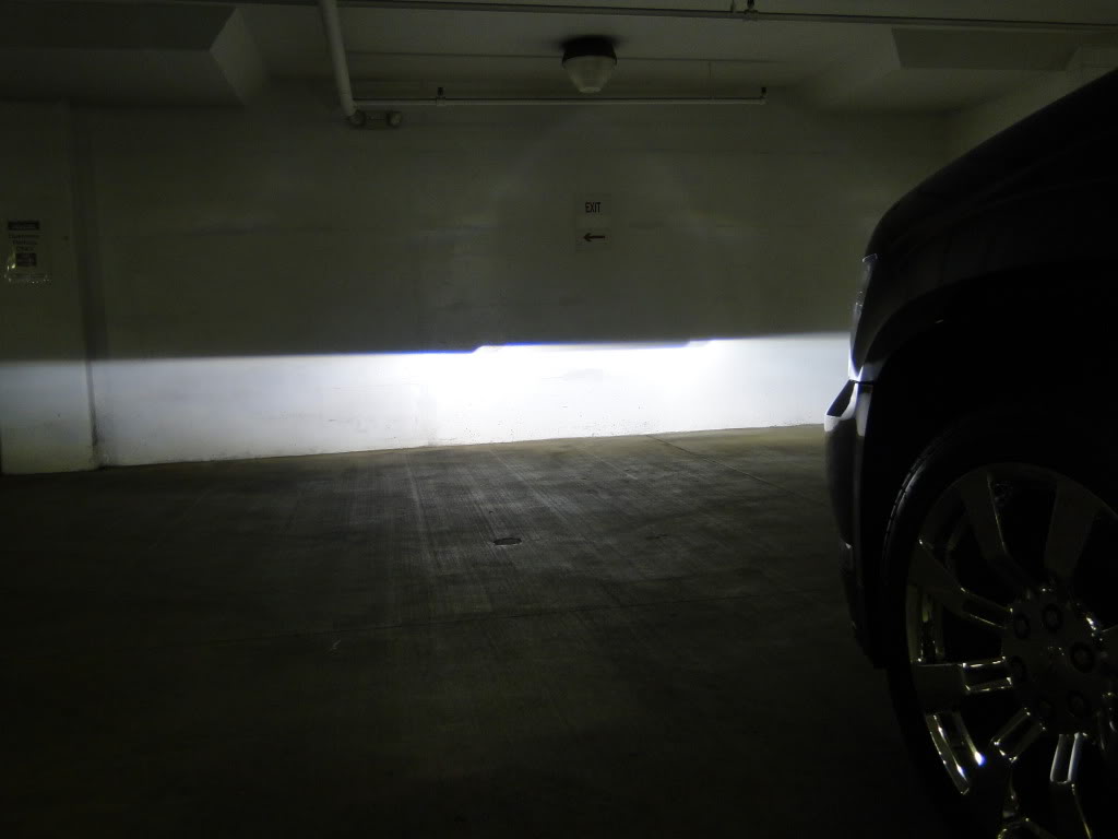

On my truck:
picture.php
What did the output look like?
picture.php
Some are worse, some a tiny bit better, but light on the road is catastrophic and highly dangerous, as there's practically none.
They actually get worse with HIDs in them because., although they are poorly designed for halogens, they are outright allergic to HIDs.
Not to mention the led/ccfl/halo hardware is of poor quality and will fail sooner rather than later.
Not much more can be said bout them, just pass.
