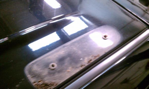

Wife got into our 2011 Tahoe after being parked outside in the rain and discovered water leaking out of the seam in the oval piece above the passenger side seatbelt.
Need to take it to the dealership. But does Anyone know how the water is getting in?
Could it be coming from the roof rack? I installed the Esky rack a few months back. however It's rained a few times already before yesterday when this happened.
Water dripped down the side pillar and gathered on the floor mat

Damn, so I'll have to take the whole rack off. The only way it could be getting in is thru the screw holes. Do the holes go straight thru? What's the remedy for this? Silicone?

You used all the holes to mount the rack right?
I mean the Escalade rack has the same mounting holes as the stock rack right?
MACHO
MACHO
Aug 10, 2012
1,540
Seattle, WA
Yes, all the same holes. And used all the same bolts including the plastic retainer on the middle bolt which holds down the Esky rack That's why it's weird that that much water would be coming thru. That seems silly of GM to design holes that go thru the roof, but I wouldn't put it past them :)
