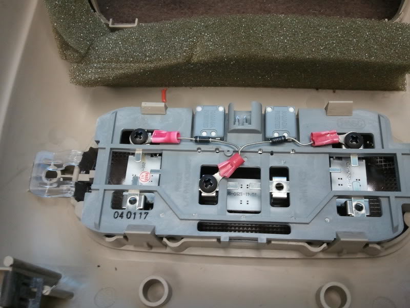

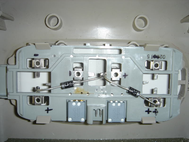

i installed led bulbs in my dome lights but i wanted to be greedy and have them all come on when the doors opened so heres what we come up with. pretty much its the same procedure as doing a 4hi or 6hi headlight setup. on the backside of the dome light assembly i jumped from the 12v side of the center bulb over to the 12v side of the side bulbs with diodes in line so no back feeding. the bulb mounts have spots where you can force a screw into it to make contact. the side bulbs still function like normal when the individual buttons are pressed but when the doors are opened, all 3 bulbs come on. i did this to both dome lights and i love it! heres the only pic i have. cant really post a pic of the light on because its so dang bright it screws with the camera.

What size ? diode did you use?

honestly i dont have a clue. they were just some laying around at work.
