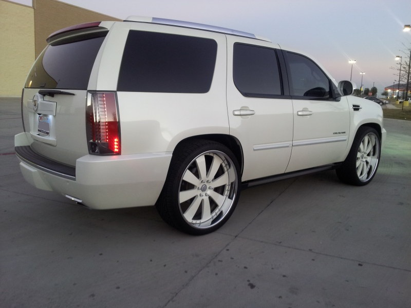

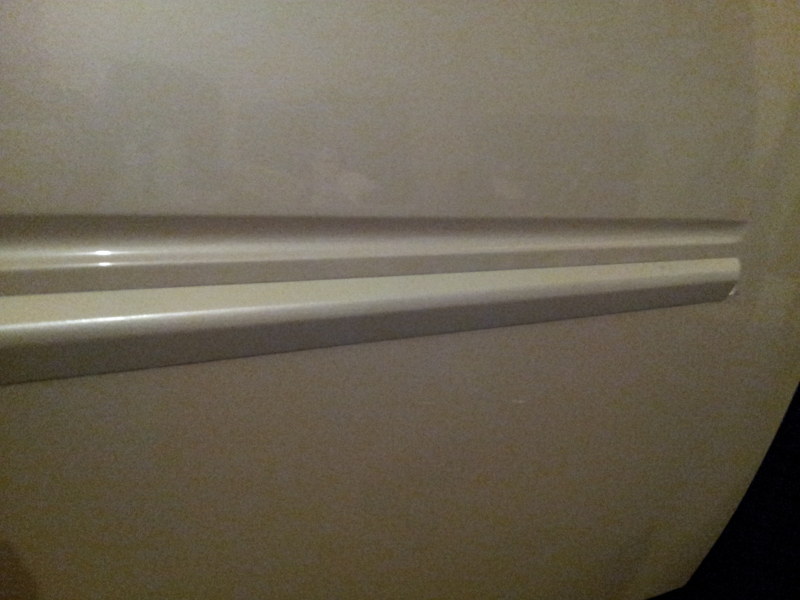

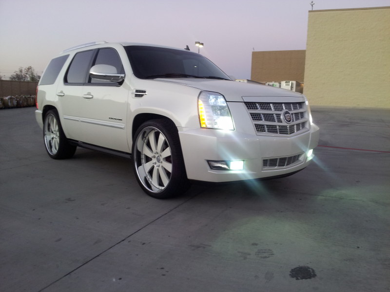

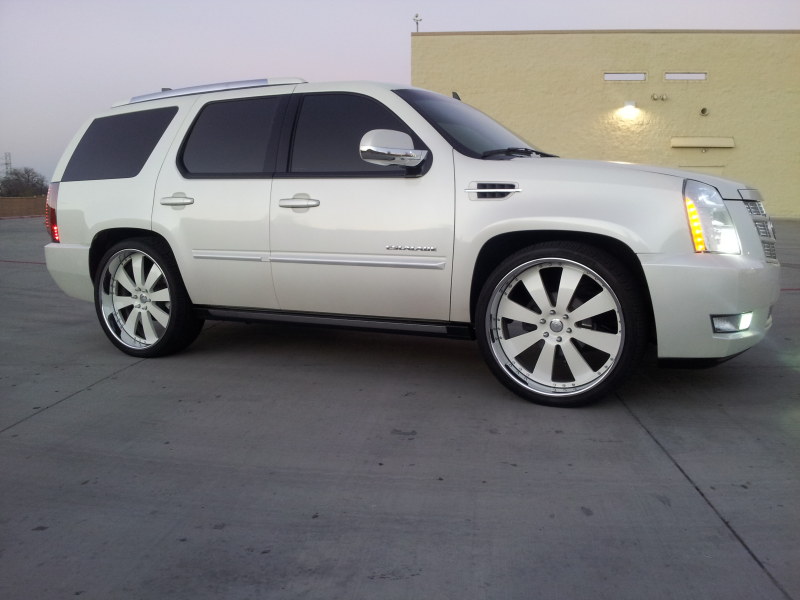

So I took some quick pics after I finished up all the paint match trim (Plastidipped) and got the power running boards mounted up (not yet wired). I've got the Plastidip Pearlizer almost down to a science, everything turned out good but I got a little run in the clear on the liftgate applique because it was too cold and the spray pressure was too low, will probably wetsand and/or redo. I plan to do the running boards pearl white as well, but will probably be when I have some time and its warmer.

Looking real good Josh.
It just keeps getting better.

Those wheels are sick.
This is best looking escalade I've seen.

I know old thread. But you have any issues with Power running boards rubbing the 26's? Trying to decide if I want the power running boards or not when for my Escalade.

havent been on here in awhile but ran across this....no lowered 2/3-4 with 26x10 and 305/30/26 I do not rub the running boards. It does / did rub the liners and you have to mold / shape them but the running boards are fine. They are adjustable front to back and you can get them centered so they wont rub
