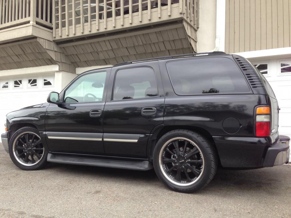

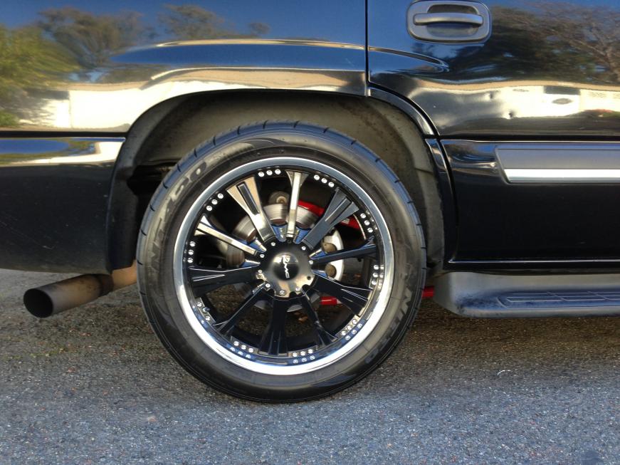

DJM 3/5-6 on 2004 Tahoe
Hey all, just finished my DJM 3/5-6 drop, I put a couple of pics togather for you guys. Lots of extras, Like rear helper bags. and the Spohn upper and lower rear control arms and Spohn panhard bar.
The ride is very good, you MUST cut out the old rear bump stops to allow the suspension to work correctly.

dan your running the tb rear spring the 6 inch just came out last week. Truck looks killer
By positioning the rear axle back it lifts the truck up a little also. Same thing happens with the trailblazers.
