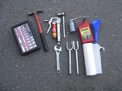

Picture of tools (BYOB):

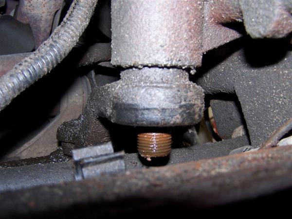

  6. Using the uber crescent wrench, from the front of the truck, strain your back trying, and then eventually succeeding to get the pitman arm nut off of the bottom of the steering gear box. Beer helps numb the pain. There's a little plastic clip that will be right in your way to piss you off, and it is really difficult to get off. It connects to the front brake lines. Don't waste your time trying to get this thing off.
