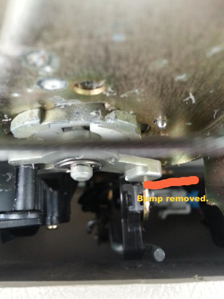

However, today, I fixed my rear glass that hasn't worked since I bought her. I pulled off the trim and after playing with it, decided to Dremel off the bump on top of the plastic lock actuator.
When you push the button, it is supposed to push down on this plastic to open the latch. The bump caused the plastic to hit the button's metal bracket which would then slip past it, instead of opening the glass. I couldn't find any way to adjust it so my fix was to clearance the plastic to allow it to slip underneath the metal from the button.
Sorry, I didn't get a picture of before because I wasn't 100% sure if this would work.

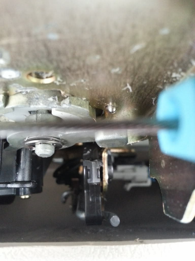

First thing is to remove the grab handle and then carefully pull off the trim - it is attached like all other interior trim, with the metal clips.
This is when the glass is locked. The plastic actuator rotates away from the button.
![20130330_175015.jpg 20130330_175015.jpg](https://www.tahoeyukonforum.com/data/attachments/139/139212-9a97e75216a9f1c00683f0631d63c997.jpg)
This is the clearanced plastic underneath the button mechanism. Now, it slides underneath the button when it unlocks instead of hitting it. Dremel skills aren't perfect.
