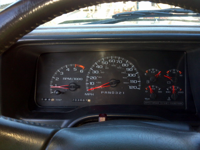

Well, I promised that I was going to get them in on a warm day... Finally got one the other day, and I forgot to post these...
I am very pleased with them, and they are not that hard to resize to fit our clusters. You will however need 2 sets out of 2 clusters. The tach needle is too small for anything, so you need 2 speedo needles and 4 from the temp and fuel gauges...
What do you think?

looks pretty cool

Where is the best place to find some that wont cost an arm and leg? Are those factory ones or after market? I am sooo getting me some for my hoe!! Best ones I seen in a log time :)

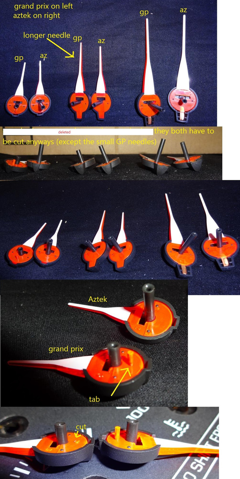

These are also the gauge needles found on the last generation Pontiac Grand Prix, which makes them more common than you'd think.

That is correct. The 2004-2008 grand prix also has them. They are slightly different than the aztek needles. The tach needle is about 1/8" longer and the stems on the needles are different lengths compared to the aztek.
I will be switching to a grand prix tach needle soon, as it is a better fit for a tahoe/yukon cluster than the aztek tach needle.:cheers:

comparison between the two and insight into whats envolved when doing the swap:
tach needles
speedo needles before trimming the ends and also an example of a speedo needle on the tach
small needles before trimming the ends

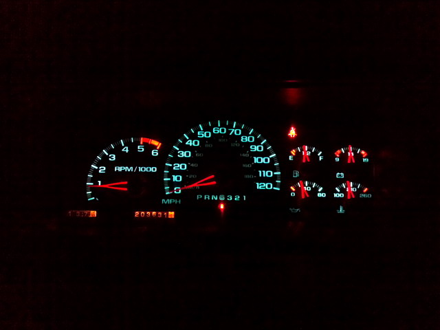

I did mine. Thanks Dylan :) I just got finished switching out my blue LED's to red. Ill post up pics tonight to show how they came out.
