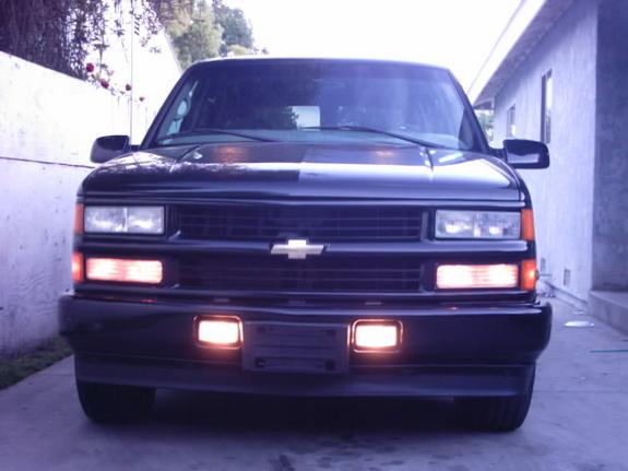

OK I bought a 2000 Tahoe limited that needs the fog lights so my question is where can i get these and how do they mount in place?

Better let me take this 1 guys... LMC will have them... The problem is finding the mounting buckets for them... Check craigslist, ebay or even junkyards... I think the Oldsmobile Bravada, and S10 extreme and Blazer (s10) extreme use the same fog lamps... Just not 100% sure if they all use the same mounting buckets...

thanks for responding well i went down to LMC and looked at the fog lights but your right on the mounting brackets they do no come with them so time to hit up Craigslist and the junk yards hopefully i get lucky

Is there a way you could take pics of the mounting buckets on yours? I just want to see how they attach. I think my best bet would be to fabricate my own, I doubt I'd ever see one at the yards around here.

A guy on Ebay has both left and right OEM buckets available for around $25 each shipped.
look up Ebay item #140757056102
Bumper has to come off to mount them.

Images from ebay user... Yea the LIMITED, Z71 and Diesel bumpers all use the same mounting buckets... Its the S10 models that im not sure about, as far as if they can b used on the OBS...
