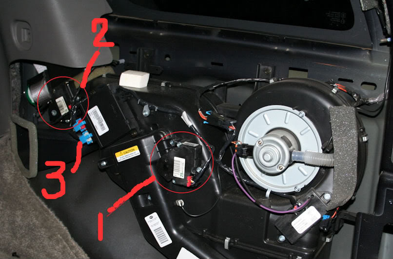

might just be the actuator, since the blower is still working, There is also a heater core in there. I have my manual that I can prolly scan for you.
1992 - 2006 GMC Yukon Vent Door Actuator for REAR AUXILARY HEATER CASE

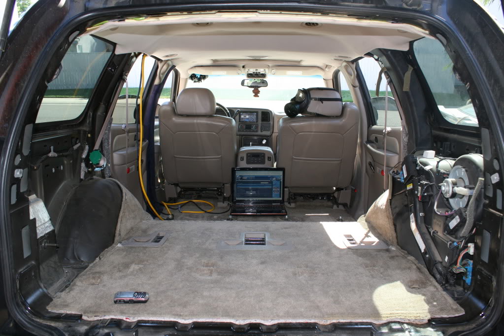

Thanks to Bliz for tearing into his truck and dynamating it, heres what the heating unit looks like:
It's on the right side. When I had some other work done, they checked it out. Not sure what all they did, but I know they pulled the panel. Not sure if they can plug up to diagnose it or if they checked all the part to see which one isn't working.
