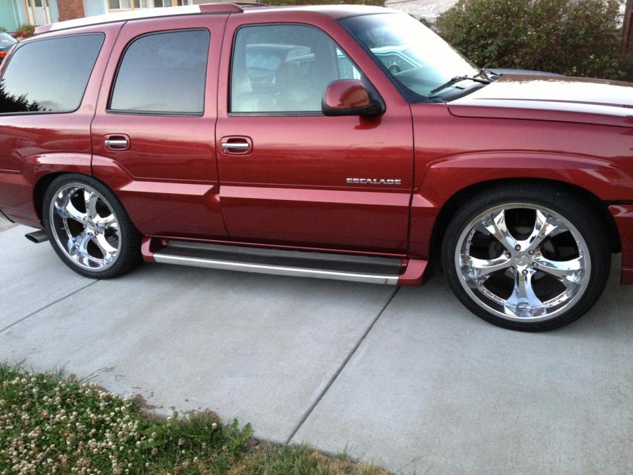

finished a customers truck over the weekend. Thanks Trevor for letting me use your pic
Kit i used (no rear spacers added)
http://www.tbssowners.com/store/index.php?act=viewProd&productId=88
He wanted to see how it sat with out spindles first so thats how I did it. No spacer in rear and I adjusted the autoride links and he towed his grand national today no issues. I will be adding spindles in the front soon.

Yes 305 all around. If i used spacer in rear would be about even.

some people like rear looking lower than front. Im going to put spindles in or 1 inch spacer back in seeing what he wants to do.
usually 3/5-6 kit people are happy with.

Right on. 305s will rub pretty bad with a arms & spindles in the front correct?

sorry 305 35 24 for 3 inches is fine
if you go 4-5 in front id get 295 30 24

What about 295/30/24? 25s scare the crap outta me lol
