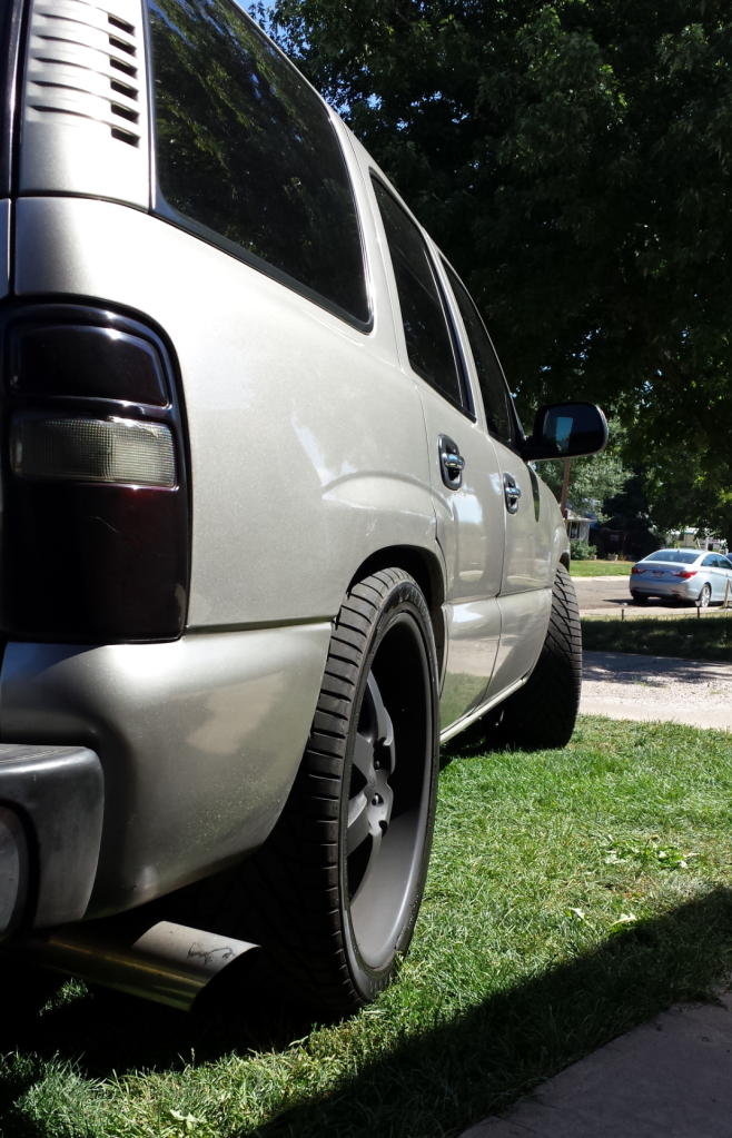

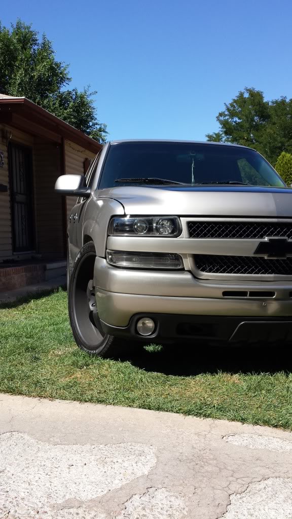

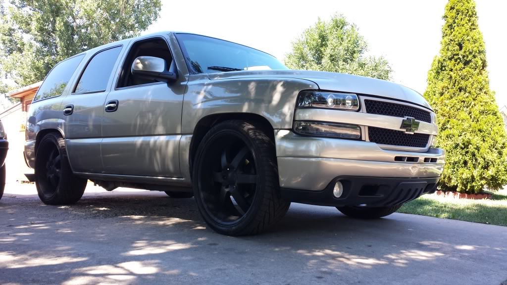

hey everyone so about a month ago i bought some 4 inch belltech drop springs at a really good deal but spoke to tony "norcal ss" about cutting em a bit to get a 5 inch drop from them..hes done them before and i know alot of guys are against it but i went with his advice and cut off 1 coil and bam! i now at 33.5 in the rear! ride quality ddnt change much but i do need to do free travel mod because its sitting on bumpstops..for the front i added some 2 inch drop belltech spindles and my keys where decranked also..it got down to about a 3 inch drop and the front drivers side is at 33.25 and passenger is at 33.5..i love the stance now..heres some pics..will need shock extenders and alignment tomarrow

Can I get one on flat ground directly from the side?
So this is essentially a 3/5 correct?

take a pic of the rear swaybar angle. Want to use the pic of a example of what it looks like without the djm links. I keep forgetting to take the local truck pics when i get them without the hardware kit in rear at 4-6 inch drop
