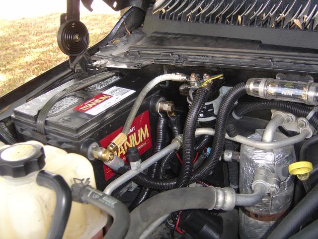

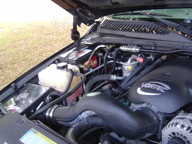

Here are some pics to show the location of the battery and isolator, cables, etc.

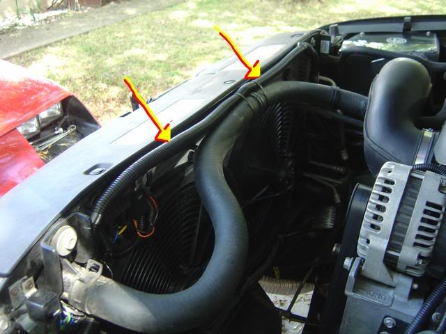

Here is the cable routed in the front:

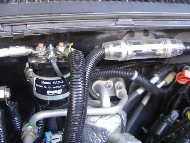

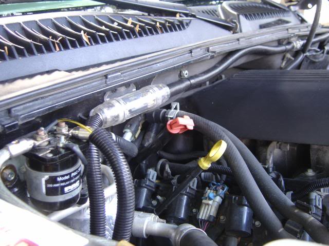

Battery Isolator and fuse/fuseholder

3). Find a suitable place for the battery isolator. I mounted mine on the firewall, right above and to the left of the a/c accumulator. Be sure placement does not get in the way of the new battery. You can attach this with some self-tapping screws and your cordless driver:

5). Attach the shorter section of 4 ga wire onto one terminal of the battery isolator. Follow the instructions that came with your battery isolator as to which terminals are which. They should all be the same, with two large posts and two smaller posts. The cable will attach to one of the larger posts (either one). Next, attach the other end of the cable to the positive terminal of the new battery using one of the sidepost battery terminals. You can also attach any cable you may have for your accessories (amp, etc) now.
6). Attach the longer run of 4ga cable to the other large post on the isolator. Also, attach the smaller 18-22ga wire on one of the smaller posts of the isolator (again, either post). Route this wire along with the cable down the passenger side, across the front over the fan shroud, and to the main battery. If you have split loom available, slip the loom over the cable and wire before routing. Be sure to route the wire as neatly as possible and as not to interfere with the airbox removal or any other part. Secure the cabling with wire ties, cable mounts, etc. as neccesary.

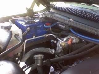

Thanks for this post, it's very helpful, i just did the same install, the only thing i did differently was that i put the battery sideways (compared to how yours is) just because mine was an optima red and i have top posts on it, so i couldn't stuff it under the back there like you did. It does rub the AC lines, but it should be fine.
also i didn't bother with the isolator and stuff, i may do that when/if i can find a suitable deepcell battery.
