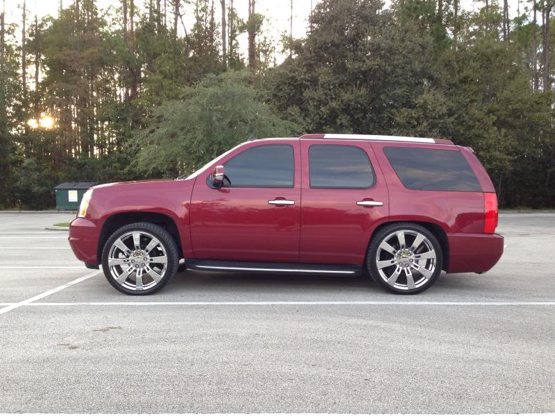

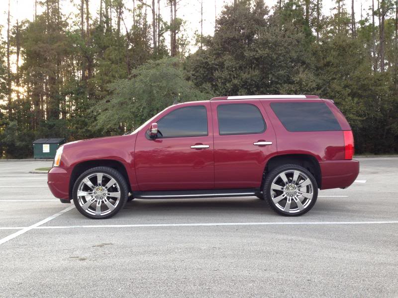

All down - Front 32" Rear 32.5" - To ride here it's EXTREMELY uncofortable and so bouncy you can't really ride here but for a minute or so.
Almost all down - Front 32.25" Rear 32.75" - I can ride here and it's a little bouncy, but I can't get camber to adjust out far enough and don't want to chew through tires. I ride here almost half the time I'm driving around town, but highway and normal day to day driving I ride at ride height
Ride height - Front & Rear 33.25" - I ride here most of the time for normal and highway (day to day) driving
All up - Front 37.5" Rear 38" - Camber way out and bouncy. I can lower it just a hair and ride all up if I'm making fun of a stock SUV on rims

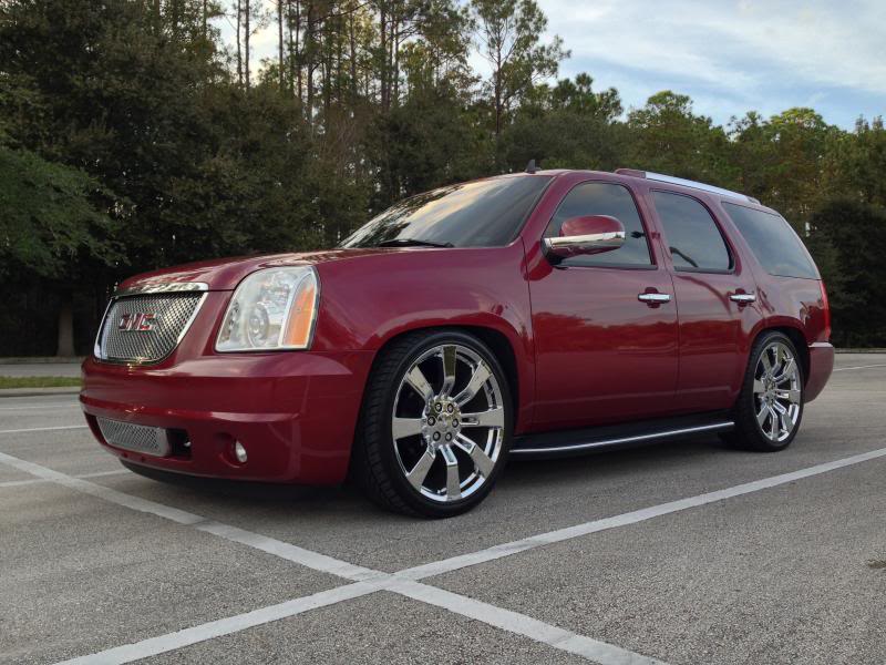

and here's some misc pics...
