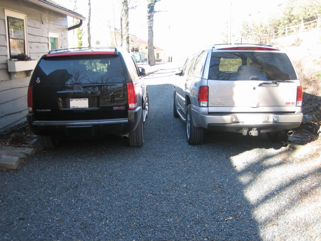

I think the switch is so that they can run the esky third brake light.
^ +1
I did not want to change the glass, but liked the color matched rear. I therefore simply installed color matched Escalde Rear Vent Covers/Appliques and I color matched my third brake light cover, .... See pic.
http://www.tahoeyukonforum.com/forum/album.php?albumid=2776&pictureid=20423

Thank you for the picture, that is a perfect angle to show the difference.
When I said I didn't know about the color of my rig, I meant I didn't know how it would look on my rig's color. I'm a painter (actually restore classics), very familiar with paint codes but thank you for the info, I should have clarified better! But yes this is a very nice modification.

The reason for needing the back glass is because the mounting points for the 3rd brake light are different on the Tahoe/Yukon back glass vs. the Esky. The 3rd brake light assembly has mounting points with screws or nuts and then 3M adhesive along the edge. Some say you could get away with just doing the 3M tape all around (because it holds really well) but most people find the entire back glass assembly and just change it out-that is a direct swap. And if you change to the Esky brake light-get the rear appliques to match the contour of the 3rd brake light. Those are also a direct swap.
