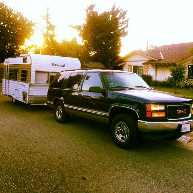

Hi all,
New to the forum and new to towing anything other than what my old S10 could handle. This summer my wife and I plan on traveling the Pacific North west. We will be purchasing a travel trailer of some sorts and will be traveling in our 1999 Yukon we recently bought. I was hoping some of you could give some insight on what you would recommend as far as trailer weight and size. Also any maintenance or upgrades I should do to the vehicle. As far as I can tell she's all stock. The truck has about 175000 on it but still runs strong no engine or tranny problems as far as I can tell.
From the info I have gathered it looks like I can tow up to 6500lbs.
Its got the 350, 4x4, 4spd auto(I think they all have the same tranny?) and a 3.73 rear end if I read the codes right (GT4 G80)
It is equipped with a universal tow package that bolts to the frame. With 5000 & 500 carrying and 10000 & 1000 distributing weight.
It is also equipped with the auto leveling rear suspension. Although I fear there is a leak in the system or it is failing. This I think may be my biggest issue.
So long story short.
What size/weight trailer do you recommend.
Any reasonable upgrades recommended? I've seen some recommend a trans cooler and such
Any maintenance you recommend other than the obvious?
I will be replacing the intake manifold gasket soon and along with that will replace: plugs, wires, cap& rotor, all related gaskets, and will be upgrading the injector spider to MPFI. I already did a full brake job and will also service the tranny and differentials. Anything I am missing?
Thanks in advance for any input it is greatly appreciated.
