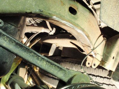

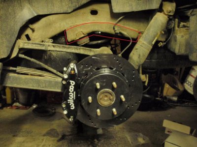

You all have helped me a lot with my 2006 Yukon Denali and I hope I can start to give back now. I am doing a major suspension upgrade with Wilwood Big Brakes, Bilstein shocks, NorCalSS Tony's 3-5/6 drop kit, and some other upgrades. When I finish I will do a whole build thread with pns, etc, but right now I am just doing the Free Travel Mod. I haven't found a really clear guide showing what to cut - and this is definitely something I only want to cut once...
Is this the correct piece to cut off? Do you cut the entire thing front to back below the frame rail, or just a section of it? Any advice on modding the bumpstop? Ill post before, during, and after pics once I figure it all out.

Yup. And then grind the rest so you do t slice your tires or your hand or something crazy ha
And then install some 3/4" pancake bumpstops. I drilled and tapped a hole for mine and then threaded them in.

Like Knobz says, you got the part right. When I did my free travel mod I pulled off my wheels and put the rear of my Tahoe on jack stands...just like the way it looks in your picture. I used a combination of a sawzall and a rotary grinder. The passenger side is pretty easy. The driver side requires care since the gas tank is right there. As long as you look over the area well and take your time you'll be fine. Good luck!

Yes I use a sawzall cut below frame and good to go. The bumpstops I ship with the kit fit thru the oem hole thats on the axle pad

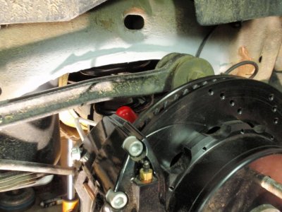

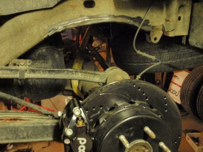

Last night I did the Free Travel Mod. Attached are two photos with the bracket cut, and one showing why its necessary. I pulled the wheels off and used a Sawzall - worked great. I was originally hoping to do it before pulling the springs, but they started to interfere with the blade, so I ended up removing them half way through. Everyone who warned about getting close to the gas tank is very wise - there is not much room to spare when cutting the drivers side.
Hope the photos help the next guy wanting to do the mod.

Any blade recommendations for the saws all tony? Length, brand, tooth?
Lentsnh2012
Jul 5, 2013
108
Obviously don't get a blade for wood cutting, but I just picked up some Milwaukee heavy duty blades.
Be careful because the blade gets pitched a lot. Cut it at an angle and have a 8" or longer blade. A 6" blade is just too short to cut the bracket sides at the same time.
