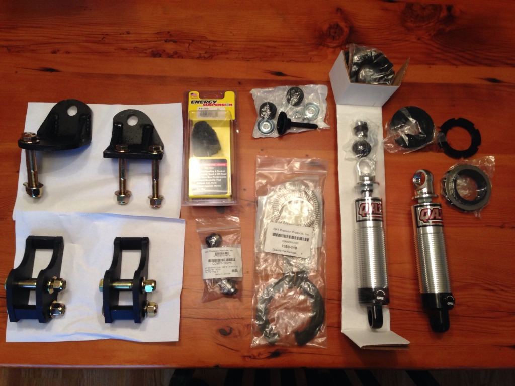

First what is needed for this:
PARTS NEEDED
Click all pics for bigger ones
--Long shocks on both outter sides are my rear shocks--
Better pic from Iregrets install
Few notes on parts list
When ordering parts make sure you double check what you are getting. (read the parts descriptions) I choose the DS301 shocks per Richard (Atomic) suggestion as it was the correct shock for my application. So, be sure to use the correct shock for your application as it will differ. (unless you want to replicate my setup)
If ordering the DS301 shocks do not freak out when the shock is received, it is about the size of a cell phone. It will work though.
The spanner wrench and bearings kit is an optional purchase, but will ease when raising or lowering the coil overs.
Bearings shown only
Must order the COM8T Steel Bearings. These are upgraded bearings from the original qa1 shocks. These will be able to handle the weight of the vehicle; the poly ones supplied w/ the shocks will get destroyed quickly. 4 bearings will be needed if you choose the pro-comp adapter way, 2 for each shock. If you choose the stud top mount, then only 2 will be needed for the bottom of shock, but will need to purchase an upgraded bushing for the stud mount. (currently none have held up to my knowledge 3/1/14)
Pic of steel bearing installed
Pictures below are why I went with the Pro -Comp adapter instead of using a stud mount w/ bushing.
Poly Bushing that comes w/ qa1 shocks after only just sitting on the weight of the truck (pic courtesy of Iregret)
Bushing installed - notice how squished it is
th_20milesonbushings-washers_zpsb86c9bd8.jpg th_ployurethanebushings_zpsbf8b7880.jpg
The rest of the parts are self-explanatory, if not feel free to ask. Most of my information and research came straight from Atomics threads (and communicating with him personally) as well as FILL IN with his help.

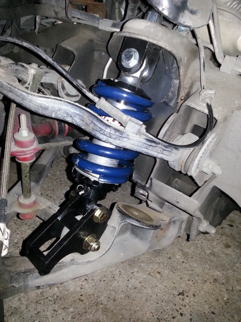

  1. Place atomics upper bracket on upper shock perch. (the one meant for the side you are working on. There is a driver’s side and a passenger side)
  2. Get the pro-comp adapter and using the supplied nut, bolt it up through the upper bracket & shock perch and tighten it up. Make sure it is placed well and flat against the frame. There is a plug there, (speed sensor?) it will make contact, but I did not have to unclip mine. My bracket did not go completely flat as the shock perch on the frame was added after GM made the frame. (So, it is not flat against it all the way, but very close)
  3. Then take the lower bracket from Atomic and bolt it to the hole on the lower control arm where the shock bottom would normally bolt to.
  4. Next take the assembled Coil-over and do a mock up. Making sure all is right and fits correct. **note, I had to jack up the LCA a little to get the shock to mount to the top, this appears to be normal from my research, does not affect anything**
  5. While mocking up is being done, check for clearance all around the spring. I.E. will it make contact with anything, but remember you have no load on the suspension. To double check at your discretion jack up lca to normal level and check clearance.
    Pictures of clearance that might cause issues (reason for cutting)
  6. Now it gets interesting and power tools are needed. (Think of tim allen) Mine spring was hitting the very corner of the bump stop and bump stop bracket. (the piece of frame/metal that the bump stop bracket is welded to. ) In order to fix this dilemma that piece needed to be cut, (as atomic has mentioned). If you fear cutting up your Tahoe then maybe this is not for you, but I guarantee it will be well worth the heartache. Basically your cutting an angle off that bracket. (hopefully picture makes more sense) **Take off shock before cutting to not accidentally cut the shock / spring. **
    th_stopcut_zps2c363bd1.jpg th_20140301_185222_zpsc754c7f4.jpg (Iregrets Cut) th_Cornercut_zps1463b4ea.jpg
  7. Now w/ the corner gone, double check fitment and clearance.
  8. Everything looked good to go on my setup. Now, here is where install will differ from others.
  9. Take off the shock, but leave the pro-comp adapter attached to the upper bracket, but remove shock completely.
  10. Weld the upper bracket to the frame. For assurance spray w/ rust-o-leum or similar since raw metal will be exposed as well as on bump stop where it was cut.
  11. (Or you can drill holes in the frame and bolt the bracket to the frame. I choose not to do this b/c after looking at it on the driver’s side where the bolts / holes are supposed to go, the engine motor mount is exactly right there. I saw no way to get to the bolts on the inside of the frame to tighten them down.
    Here is what your working with on the inside of frame
  12. The upper bracket is optional honestly; it is just for reinforcement of the upper shock perch. So if hesitant at all, you can try to just use the pro-comp adapter and disregard half of 6, 7 & 8. I have seen others in my search that are doing it that way.(no information on how it has held up)
  13. By this time, the upper mount should be welded on, pro-comp adapter bolted up and tight and upper mount done. Hard part is now over.
  14. Now get the coil over and mock it back up again. Bolt it to the bottom bracket & the top, (jack up lca if needed to reach / mount top shock bolt to the pro comp adapter. I had to jack it up a little.
  15. Here is where I removed my Torsion bar setup. The bars & keys but left the x-member. (it serves no purpose as there is a real x-member right behind it.)
  16. If all is good and well, tighten up the bottom bracket- both bolts. Then tighten up the top bolts. Basically tighten all bolts. (you can tighten up the bottom bracket in the beginning if you choose)
  17. Now, you should have the coil over fully installed and ready to mount the tire back up.
  18. Sit back and take a break after both sides are done and admire that both those 5” shocks actually fit (if you choose the shocks I did)
  19. Put wheels back, tighten accordingly and lower vehicle.
  20. Check clearance / movement / measurements etc. and that you can get off lift. (ha ha)
  21. Re-adjust if needed, remember suspension has been messed with. Go for a test drive and come back and re-measure and adjust to desired height.
  22. That’s it, all should be tight and adjusted and the ride improvement should have been felt on the test drive.
  23. Now go drive it again and really feel the difference you just created. It is truly a vast improvement of t-bars.
The install time depends upon you or the installer. It took me and my friend w/ a few breaks about 2.5hrs, testing / fitting / mocking / assembly of shocks/ etc.
There may be some steps I left out or did not mention some things. I was not going to go into full detail as this is really not quite that hard to do. It really is a bolt on ordeal with the exception of the upper bracket and cutting the bump stop bracket is needed. I only listed the way I did my install. Whichever top shock mount you choose will differ w/ the install. I.E. stud mount straight to upper mount. No welding or drilling required for upper bracket. Only modifications needed is the bump stop cut.

Just added pictures now.
But honestly it looks just like my Tahoe did before the install. I am at the exact height before and after, but man did the ride change.
Glad you like it! One thing I didn't see is a new lower bump stop. I think you said you forgot to order them but I highly recommend installing them at the same time and cut off the old pocket. Great review!
I also didnt notice your cv shaft?
For people asking, I have about 1500 miles on mine with no problems.
Yes, i forgot the bump stop, already ordered and we did not even think of cutting the cup off. I am planning on doing that soon. Mostly a ride check right now to make sure all is good and well. But cup is coming off when i put the stops in.
My tahoe is 2wd, so I do not have any CV axles to get in the way. (one less headache, lol)
is it possible to use this in a lifted setup?
As stated in the OP, yes to my knowledge I would think so, as your only using the brackets. The main thing is the correct shocks. That is where the length comes from. If i ordered longer shocks my tahoe would be much higher.

Boy did you come through! Great writeup!
Love the detail.
Love the pics.
Love the welds instead of bolts.
Couple questions for you...
What kind of welder did you use?
How much shock travel do you have before something bottoms out?
Have you bottomed out yet in the front?
How much did the springs cost you via ebay?
Do you think you'll need to change out the front springs to a different spring rate?
Tahoewhat
Tahoewhat
Ballin' on a Budget
Sep 20, 2009
3,720
24
TX
Love the detail.
Love the pics.
Good lord son. j/k
1. thanks, Was on fence on write up as you know.
2. Thanks plenty more to come and better when weather gets nice.
3. He did a very nice job on the welds. I made sure.
4. Miller 251 ( if thats what your asking)
5. 11.125 in. Extended & 8.625 in. Collapsed I think atomic said 2.5" either way
6. Nope have not bottomed out yet. (not much driving yet)
7. Springs were around $60 i think.
8. Speaking with atomic, he suggest the 1200 lb spring as he is using it. I do not think i will need to go higher, but time will tell. Right now the ride is awesome and especially with the qa1 adjustables i can tend it to my mood. Stiff or bouncing like an old Caddy. Floating.
Wait till i post up a little vid of this beast hopping.
