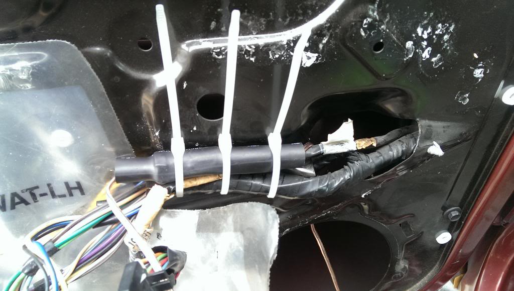

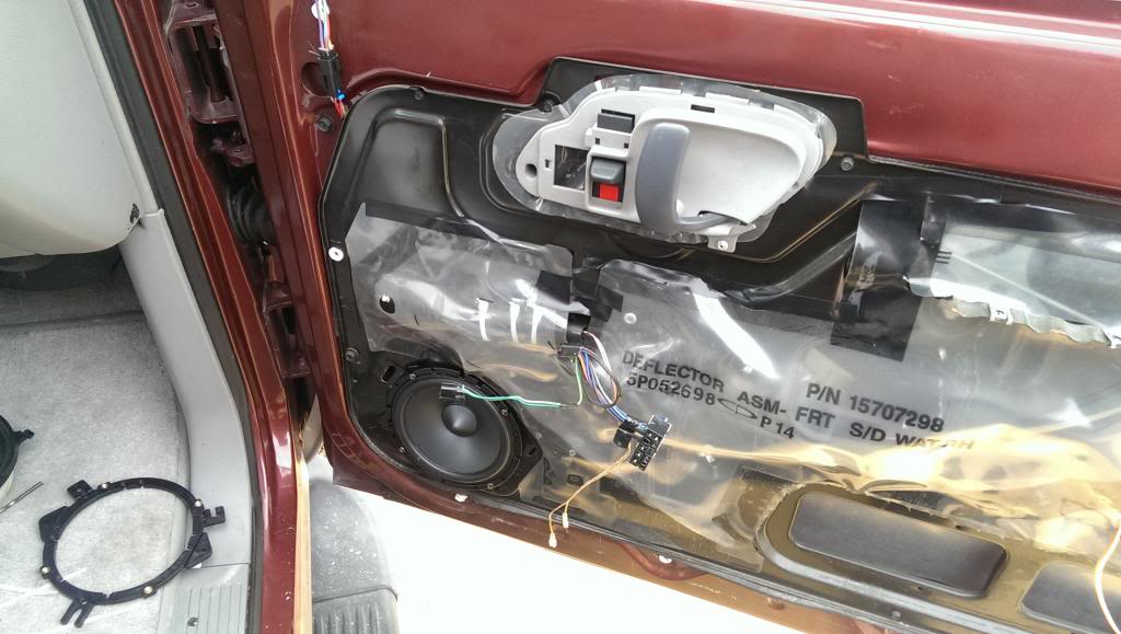

Well, finally got the speakers in. Ran out of light yesterday so had to do the passenger side today. All I can say is WOW. These speakers are awesome. Crutchfield's description said they were good even at "low" power (read:without amp) and they weren't kidding!! The first few songs were meh but after maybe 20-30 minutes these things really came alive. I picked the song I figured would be the biggest and pumped "Hedwig's Theme" (full orchestra Harry Potter theme song) through them multiple times. Let me tell you, I might as well had been sitting in a concert hall in front of the orchestra itself, it was that clear. I could hear things I've never heard in that song before, and at some points I'm almost positive I could hear the movements of the musicians playing the instruments.
Pics!
First things first, she got a bath and a fresh waxing today.
There's some beading in the second pic... It decided to get stormy after I started so I had to rush the waxing and was finishing up as the first drops began falling
The crossovers were cylindrical and were inline, already mounted on the tweeter wire. I thought it would be more difficult to mount, but I simply zip tied them to the existing wire already mounted to the door.
Passenger side in
