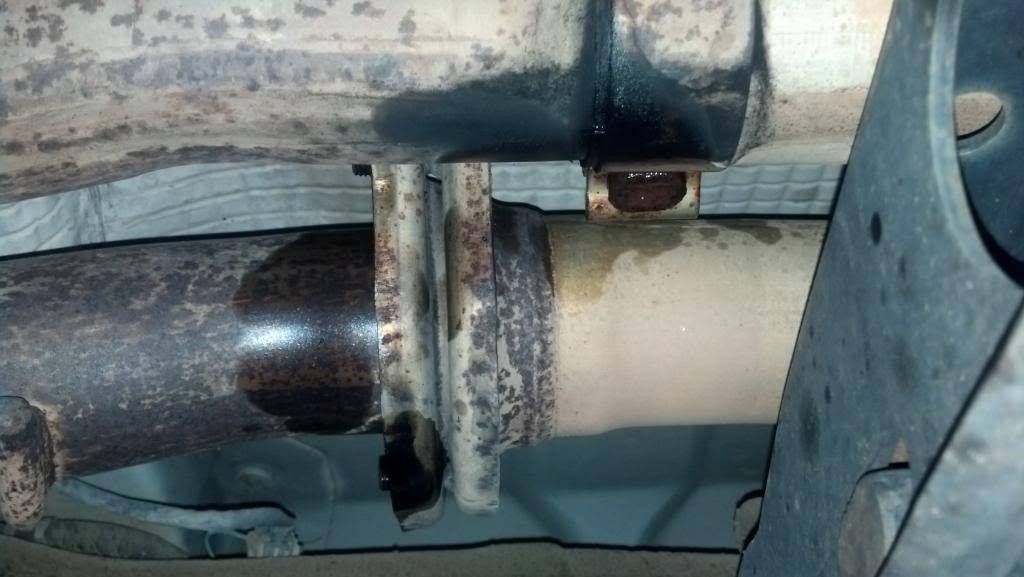

Just beyond that are the disconnects. Spray them with wd40 while you are poking around under there.
One is a ball and socket type connection with a flange on both sides. Two nuts disonnects this. The
other is a slip fit that has a clamp on it. One nut for this one and whouldn't ya know they faced
it up and put a tack weld on it. A 15mm ratcheting wrench works well here.

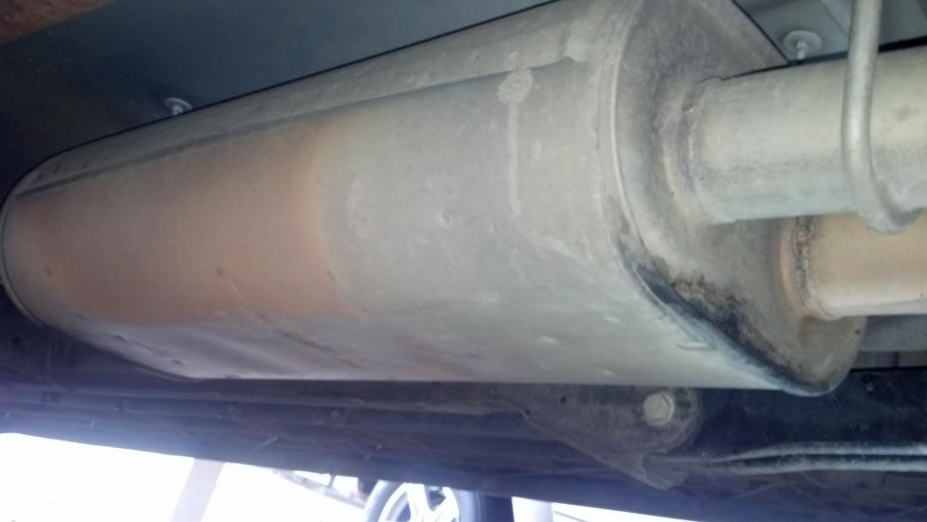

Ok, here is the bathtub sized muffler. No wonder this 6.0 is so quiet. Notice the hanger behind the muffler,
we'll be using that in a bit also.

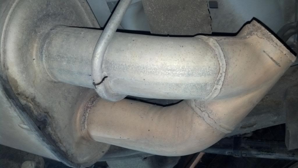

A shot of the back of the muffler, another shot of that rear hanger, and your first glimpse of the
stock merge. We will not be working past this point. This is the rear of the system for our discussion.
What's left is an over the axle pipe, then tailpipe and depending on model maybe you got a nice
pretty stainless tip (Yukon Denali's did).

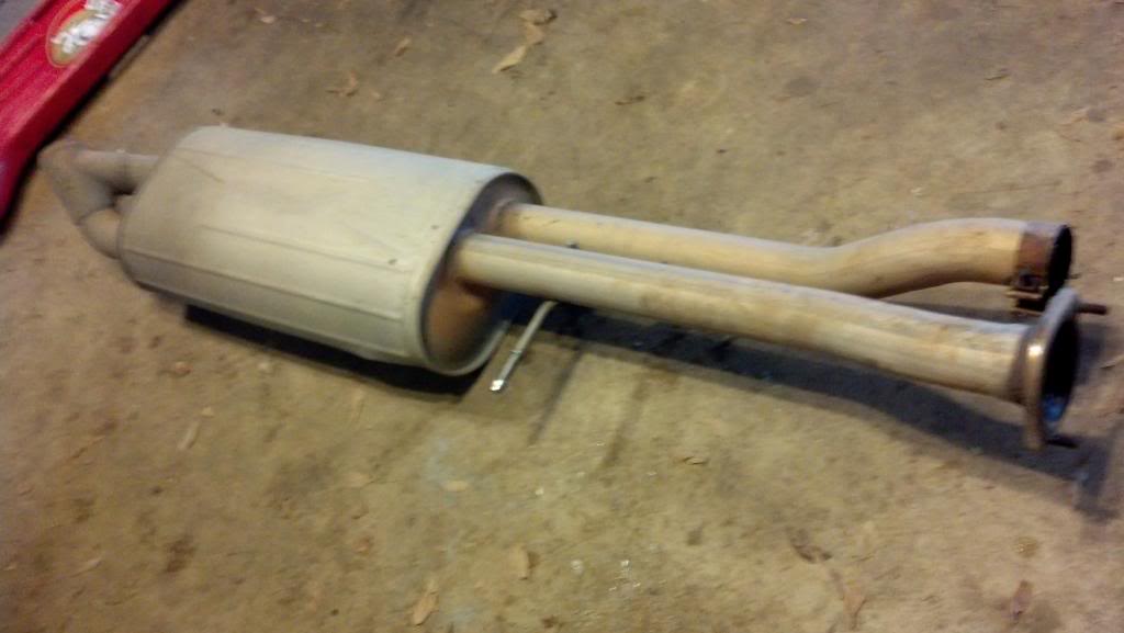

slide the whole assembly to the rear. When it gets on the ground, it should look like this:
This is a general idea of what we are going to end up with. The Magnaflow Y pipe will pull us down to one outlet,
then we will go into our muffler then out to our stock tailpipe. Because the stock Y merge was actually on the
upward slant going over the rear end, we will need to get an upward bend after the muffler. So here they are in
comparison.

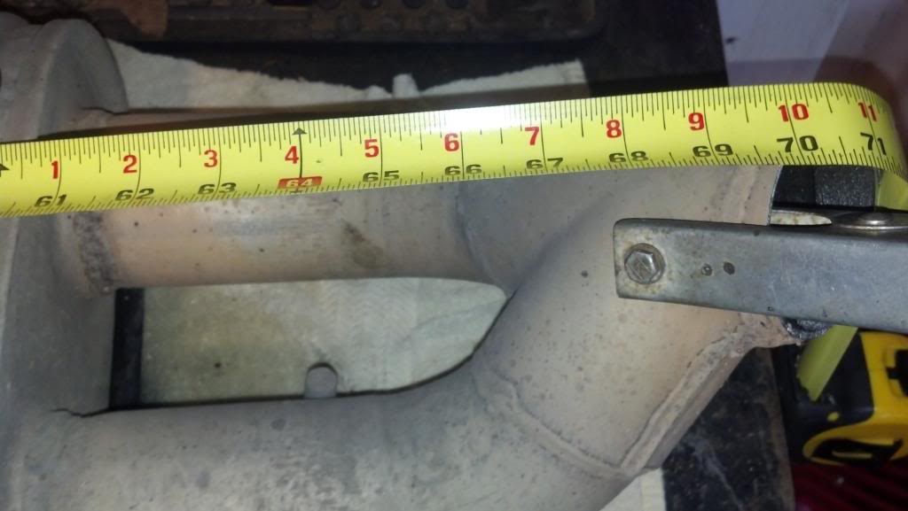

Total length of the stock assembly we removed:
Total length of our new Y merge and muffler, directly connected to each other:
Factoring in a little bit of room at the backend for our bend, we want to subtract these two figures, and
cut the stock pipe somewhere in that vicinty. Well, this ends up working out well because it is just behind
our front hanger. Which means it serves as a good marker for reference, and we will end up reusing it exactly
as the factory intended. The Xs mark where I'm going to cut, its an estimate and we will make up our distance
on the rear side.

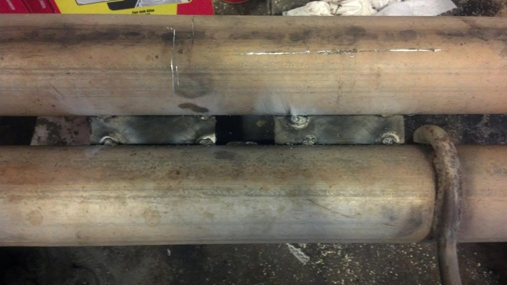

Now, before you make your cut, you will want to affix your twin pipes together. The reason is the muffler is
the only thing holding their correct orientation. Once you remove it, they will fall apart. By affixing them
together ahead of time, they will reinstall exact as they were designed to stock. Here I've inserted some
scrap metal pieces along the center of the two pipes. After my cut, they stay put.
