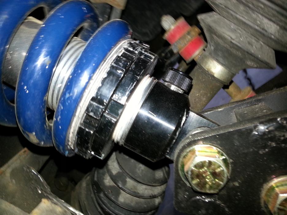

I do have one question what is your fender to ground measurements?? How much adjustment did you end up with
Fender to ground is 32 3/4" on drivers and 33" passenger now but im not done adjusting bc I still have to install my camber kit. Here's a pic of how much adjustment I have left in it. When I finished the install it was like 32" on the pass side, and remember, my tires are pretty big. Plenty of room to go down, but I need some smaller rubber first, bc at not quite full lock, these tires get in a bind and literally stop the truck if I dont give it some gas... but they've been that way ever since I first dropped it

This is an AWESOME thread. Even though you and 'Tahoewhat' did basically the same mod it's really helpful to read through your thread too. I love your collection of links at the top of your post. I was wondering about how many threads were used/unused on the shock body too, and your picture here helped me get a better idea. Mad props, yo! ;)
As an aside, yesterday (3/24/2014) I called ridetech to chat with them about the lack of reinforcement of the upper shock mount when using their airbag kit. The tech I talked to said that normally the upper shock tower on the different vehicles they've done tends to be more than strong enough, and that usually it's the lower control arm that tends to need reinforcement. I don't believe that either of our front shock mount points (top or bottom) need reinforcement.

A note about the threads left on the bottom of the shock. When I installed mine I was very careful to make sure that at ride height the shock sat right in the middle of its travel range. I made a little mark on the shaft with a sharpie before I put things together. The reason for this is you dont want the shock hanging out around the bottom of its range since you risk bottoming out. Same with the top except you risk over extension. I have also seen 40% down from the top so you have 60% travel for compression.
My point is, simply adjusting it to where it sits right might have other consequences, especially on a really short shock.
Bump stop adjustment is also critical here.
That's why im still watching that charlie murphy thread. I would love for him to come up with something to use the stud top mount to get the extra 1.5" of travel
