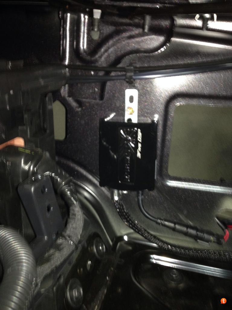

Driver side ballast mount. There is a hole right there already with pretty easy access behind it to be able to hold the included nut and lock washer. This mounting solution is not fancy but is super easy and sturdy with the double sided tape. The included hardware worked perfectly with existing holes. So no drilling your brand new truck.

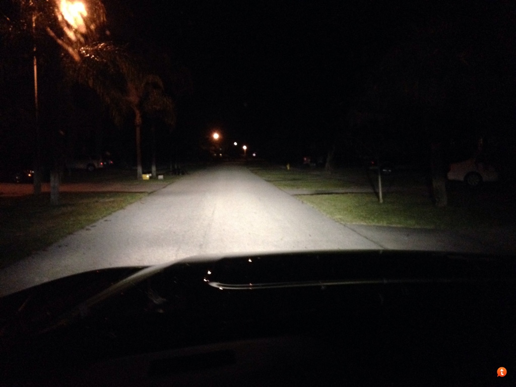

Down my street. Much better!!

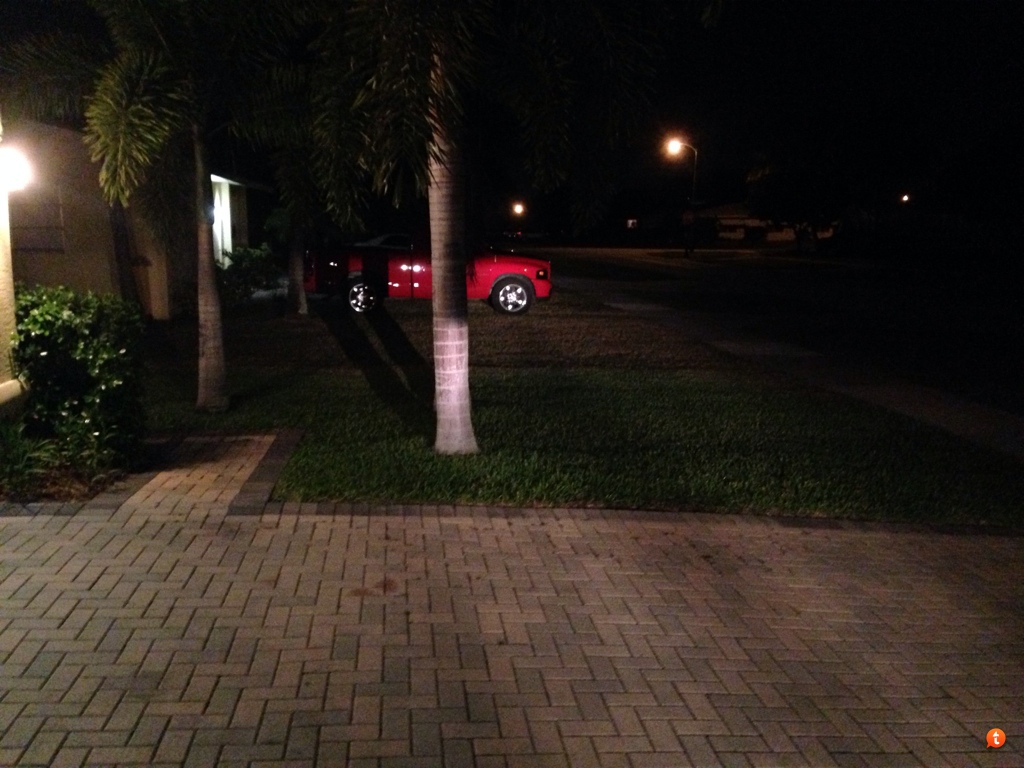

Various cutoff shots. My house is yellow so it makes the light look a bit yellow but it is pure white and matches the LEDs perfectly! In person the color difference is very noticeable and the HIDs look great!
