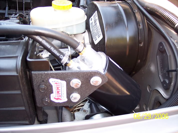

I've done this on my JEEPs that have automatics. It's much easier as you will no longer need to crawl under the truck to drop the pan and make a mess. It's just like changing a oil filter, spin on spin off. I picked out a spot on the Tahoe under the hood on the left side what looks to be a "U" shaped support bracket for the hood. Plenty of space for a filter to mount under it. With this setup, I can change the filter standing up no bolts or a pan to remove and not make a mess. Also, disconnect the input line and pump out ALL the ATF in the system when I need to. With this filter installed you no longer need to change the internal filter. When I actually get it done I will post some pics.
But to give you an idea, here is one on my JEEP.

I use a hydraulic filter made by Wix p/n 51269 that can flow 7-9 GPM which is way more than the system can pump, so no need to worry about drop in pressure. This filter is also full flow which can filter down to 10 microns which is a good thing. All the ATF will be filtered at all times, so there is no need to by pass the filter. You can install the filter any where you want, really doesn't matter. In the JEEP pictured above I plumed in on the output side from the transmission to the radiator. However, on my Tahoe because where I'm going to mount the filter, it will be done on the output from the radiator. The internal filter stays in place, no need to remove it, and I suggest you change it out when installing the external filter. This way you will no longer need to worry about changing that one out and it can filter the ATF as well, although it can't filter down to 10 microns. I have ran an external filter on my first JEEP for 34 years now and the transmission, aTF999, still runs great. Don't think it really matters where you buy the kit from as all the adapters are the same, just different port configs. You will want an adapter that has 3/4" x 16 threads and has a 3/8th's ports for the transmission line connects. You also need to be sure to use an approved transmission oil cooler rubber hose though, as not all rubber hoses are the same. Some kits offer a motor oil filter which is okay but they can only filter down to 19~21 microns. The adapter I ordered is made by Derale p/n DER-13049 as it has the port configuration the way I wanted it. My adapter should be in this week so I will hook it up this coming Saturday and post some pics.
