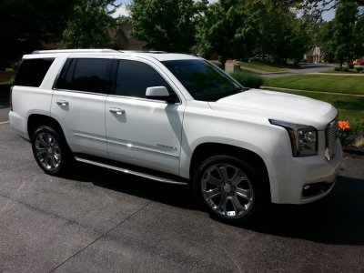

Just picked up my 2015 Denali yesterday - LOVE IT.
However, it has one VERY VERY ANNOYING problem.
At speeds 1-70 ish - it has a electrical high frequency type noise coming from the LF of the dash. Almost sounds like 2 necklaces jingling together. It is one of the most annoying sounds I have ever heard.
Anyone else heard this? The last thing I want is the grease monkeys at the dealership tearing my dash apart and breaking everything that have to remove in the process. If I had to take a guess - its either the cluster, HUD display module or something in the center stack. It sounds like one of the electrical components making the noise. Sometimes I can even replicate it sitting still. It goes away at about 70 mph and above though.
Looks awesome though.
