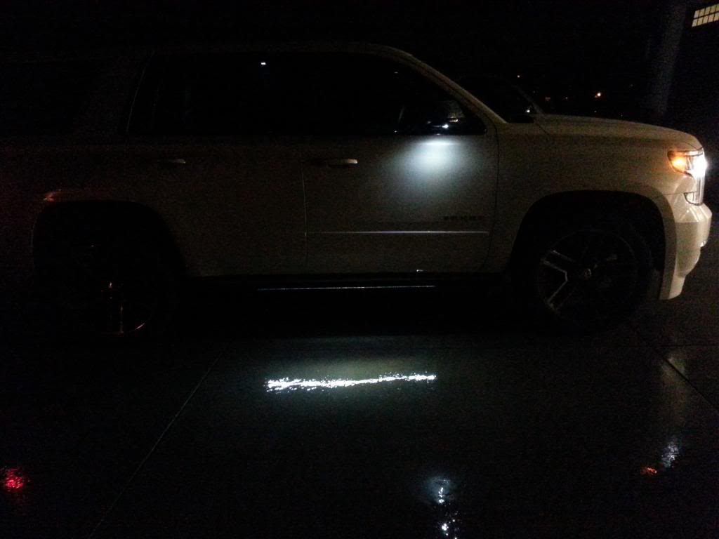

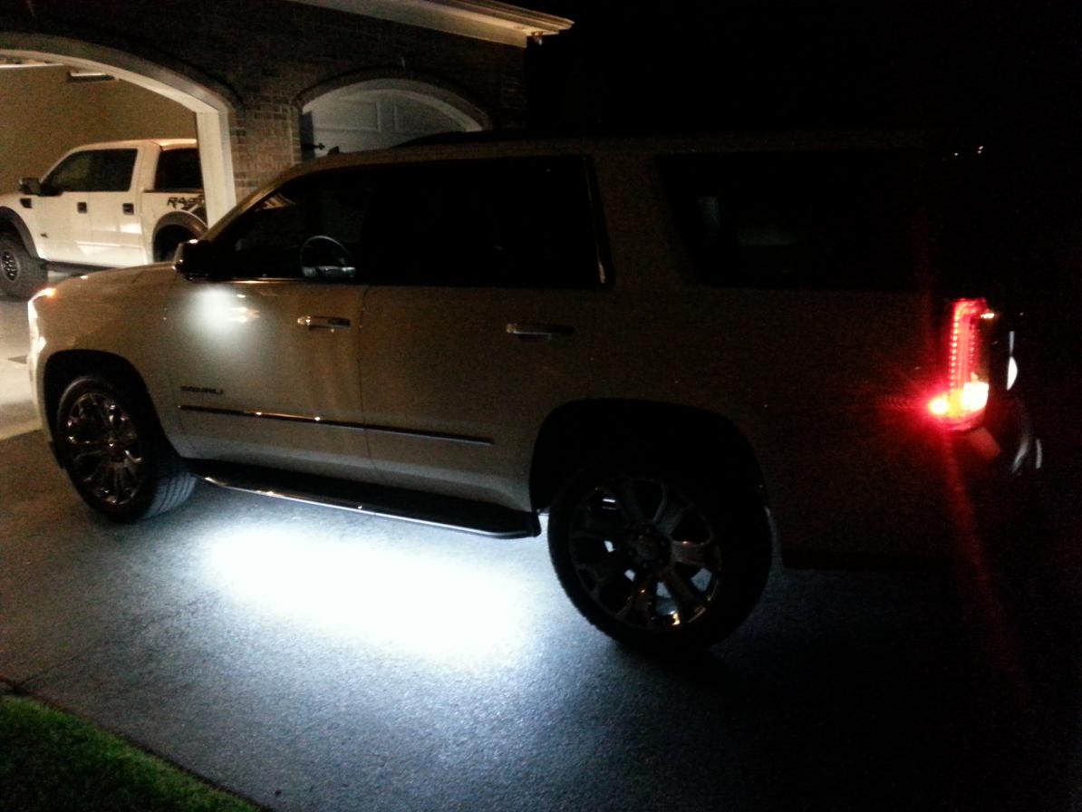

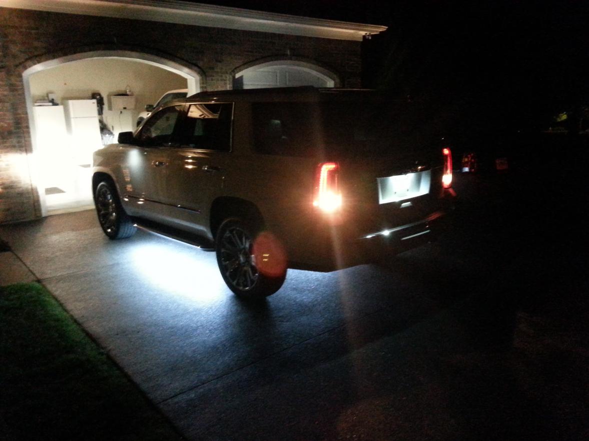

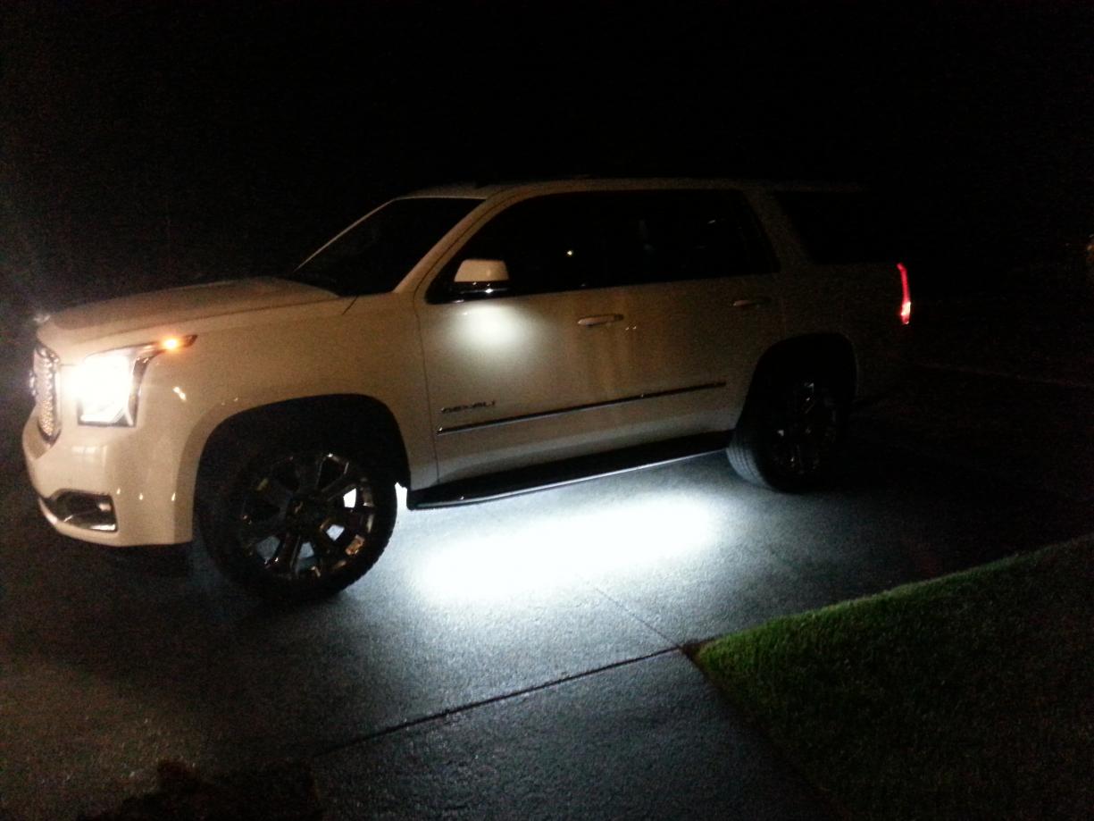

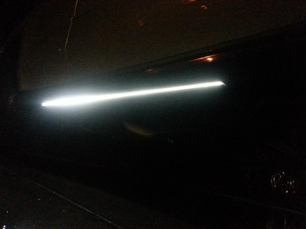

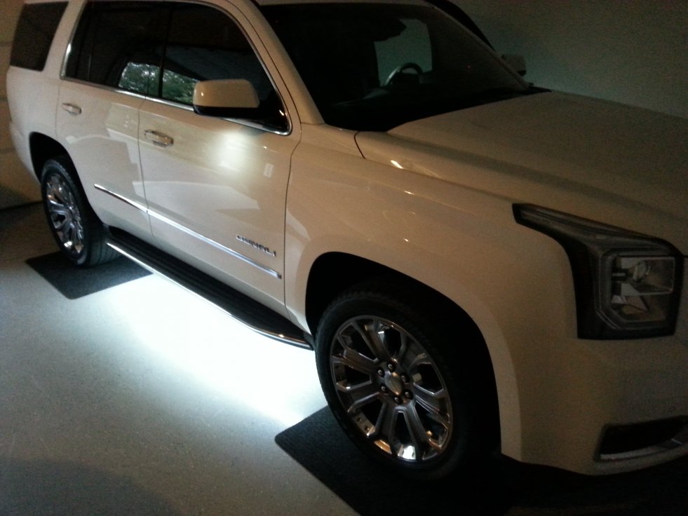

Wanted to add a little light to my Denali. I installed LED lights under my running boards and tied them into the puddle lamps on the mirrors. They come on anytime the doors are opened and when the keyless entry is unlocked. Turned out pretty nice and really looks great. Very functional too in a dark area.

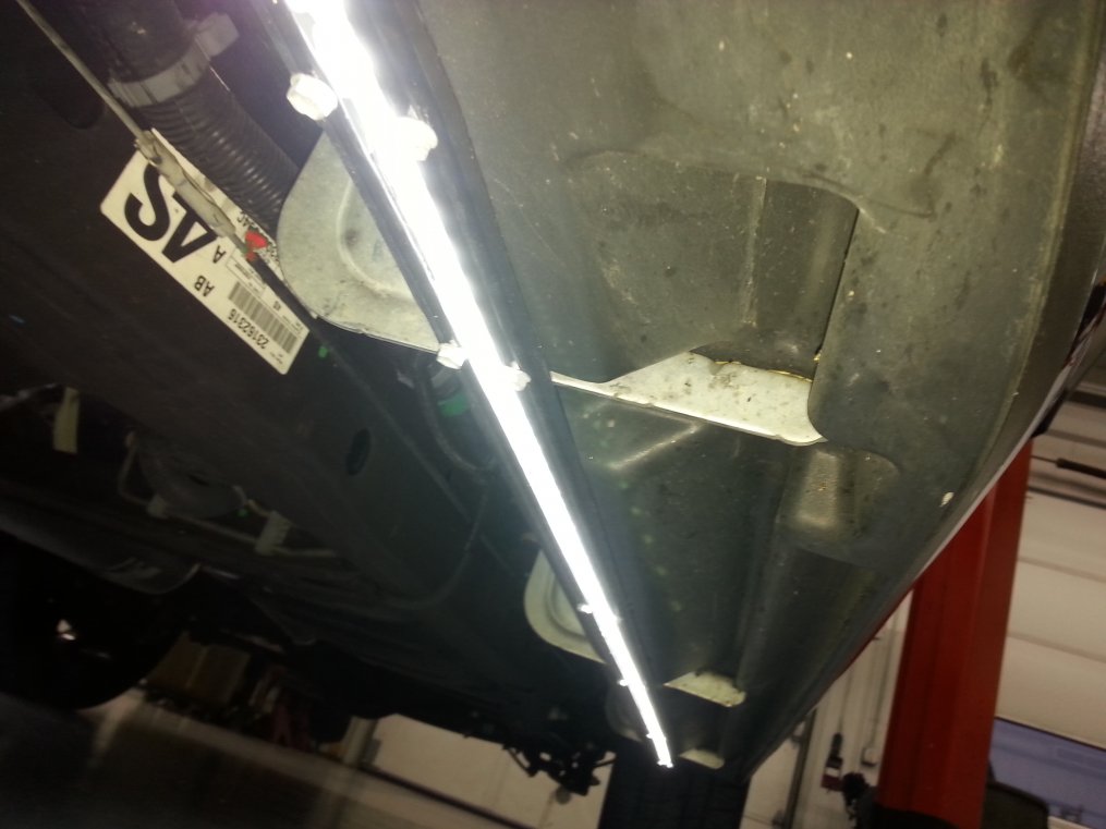

The puddle lights are controlled by the BCM. It is to the left of the steering column under the dash.
Grey connector, PIN 8, Light Grey Wire with green stripe = + voltage for puddle lights. Tap into that, there is a grommet through the floor right by the snap lock for the floor mat in the LF. I just tapped in, loomed a wire, ran it down the "Denali" kickplate and through the rubber grommet.

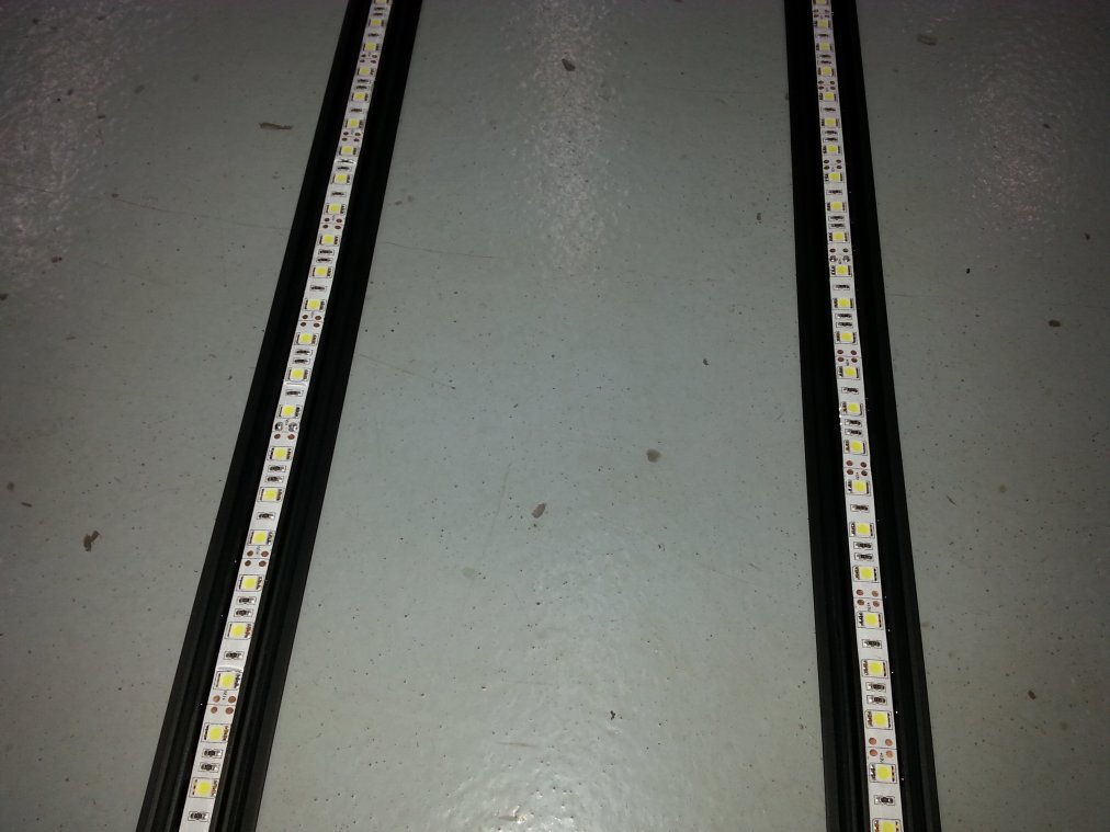

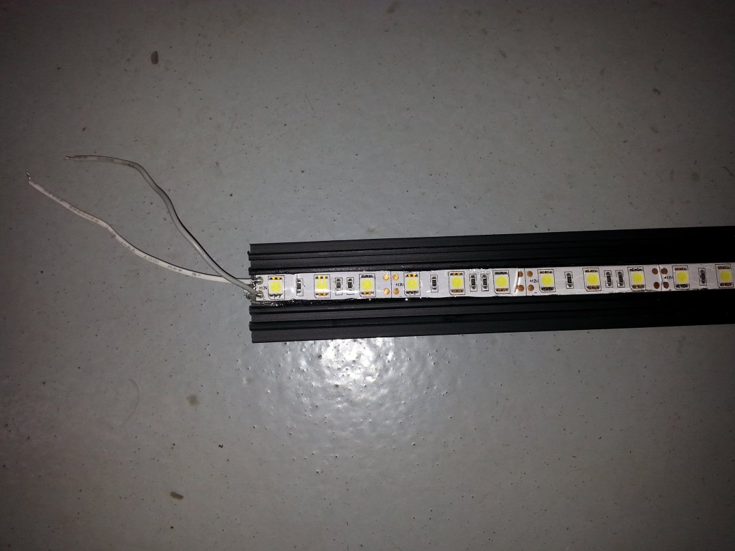

The lights I used were: http://www.amazon.com/Hitlights-Wea...762605&sr=8-3&keywords=hitlights+weatherproof
I have used those same lights in various projects for about 2 years now and they hold up very well. They have a real thick epoxy coating for weather. I did remove the crappy "double sided tape" they have and used 3M Plastic and Emblem Adhesive to hold them on. It took me about 4 hours - but that was taking my time, heat shrink and wire loom, zip tieing everything up, etc, etc.
Pull up in a dark parking lot and they are pretty awesome. I also hardwired my V1 into the mirror. That wasn't too bad for anyone wanting to do that mod.
