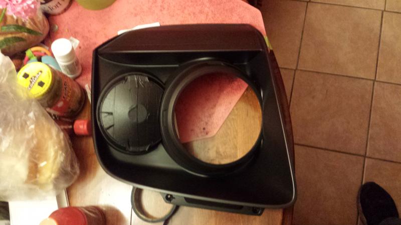

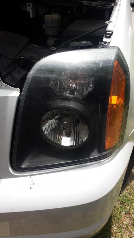

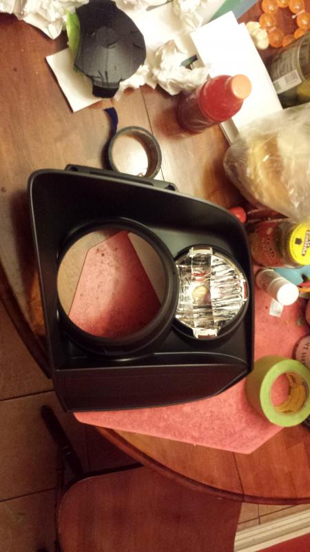

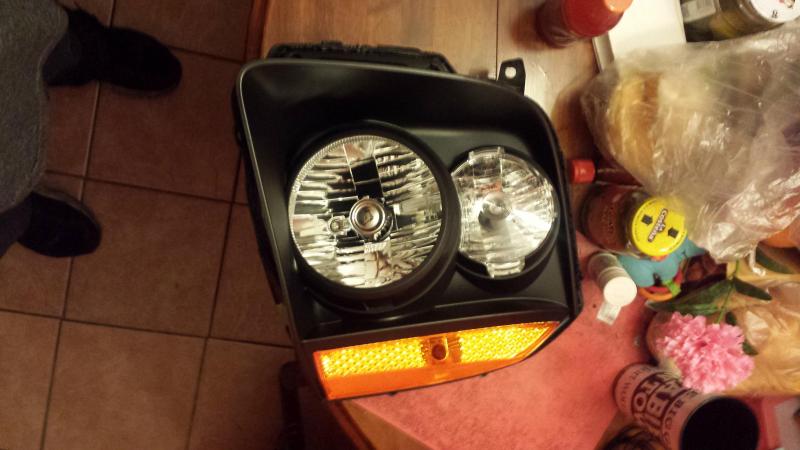

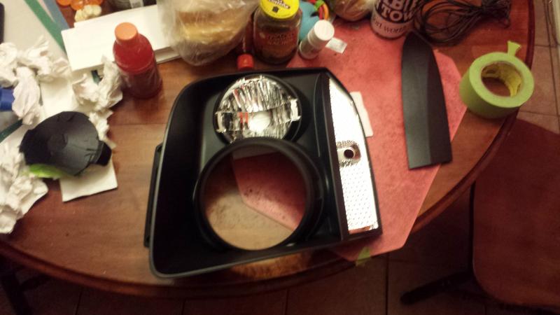

Ok, so i have looked all over the fourms, and seen black out and ,color matched head light housing. The problem i have, is that the blacked out one always smoked the amber reflector, and paint the reflective area of it black along with the turn signal area not safe!! at all and looks to out of place. With my headlamps i made it look like what i imagen if they came with black housing factory.

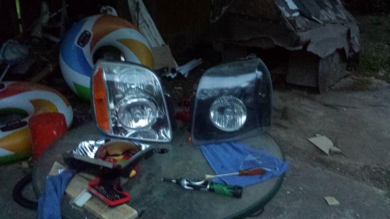

off the truck

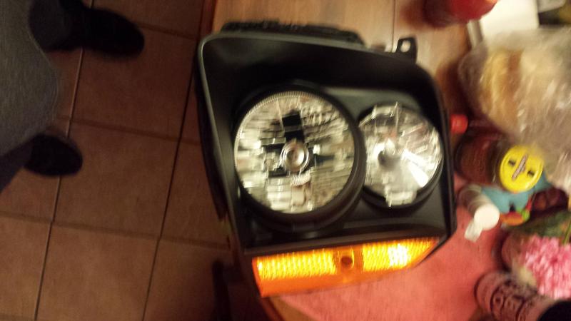

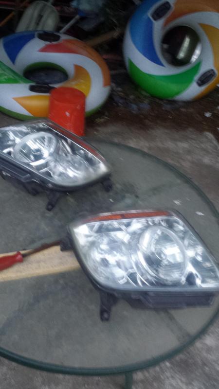

After i opend one and just placed the cover thats what most i seen look like

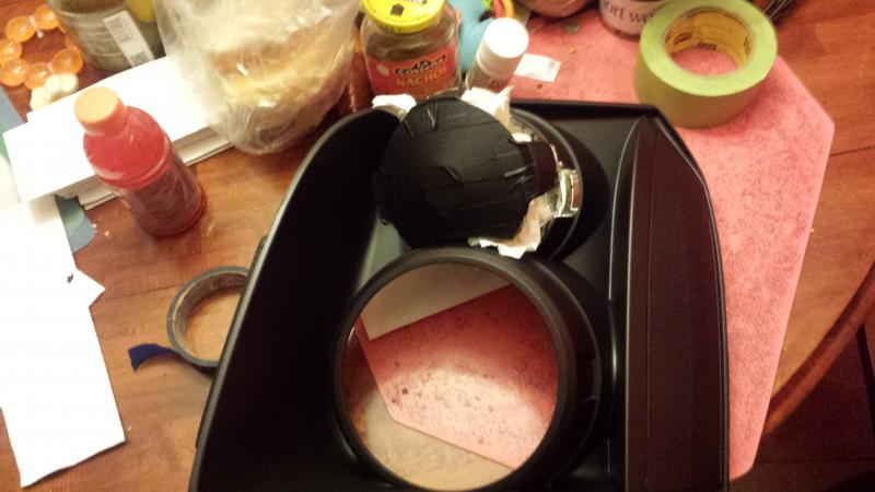

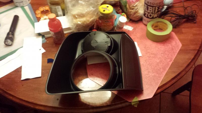

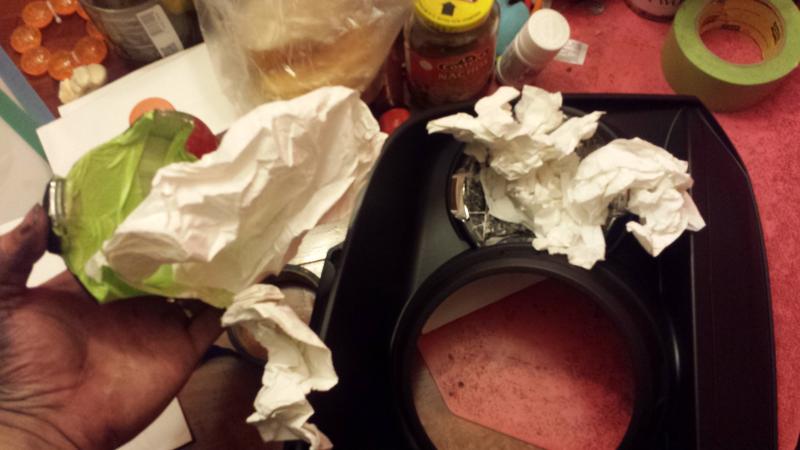

i taped up the chrome part big mistake the chrome peels of to easy so whay i did it taped the cover real good then placed them on and stuffed paper behind on the socket hole for no over spray worked like a dream

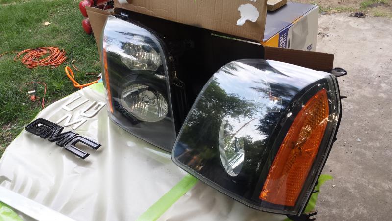

so far so good

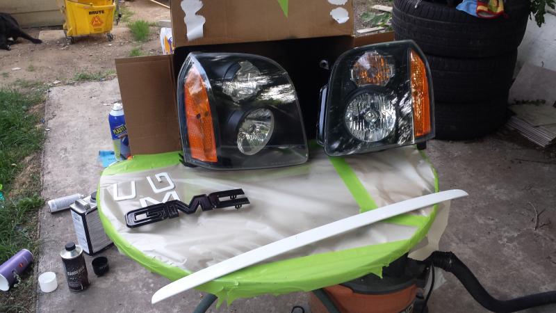

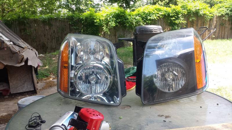

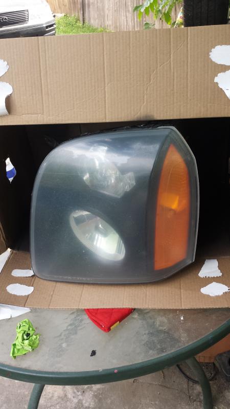

thanks for youre comments guys, im still only on the first light just to compare them after, i wish i could tdo a retro, i have some ol bmw projector but they are off like a 2000 525i so i dont think they will be good this is a test look before i clear the lense to make them look new
---------- Post added at 01:56 PM ---------- Previous post was at 01:53 PM ----------

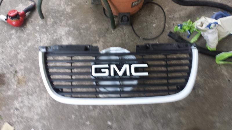

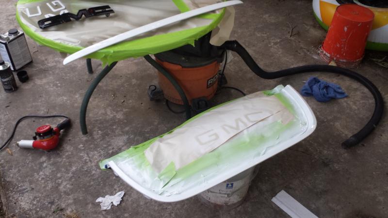

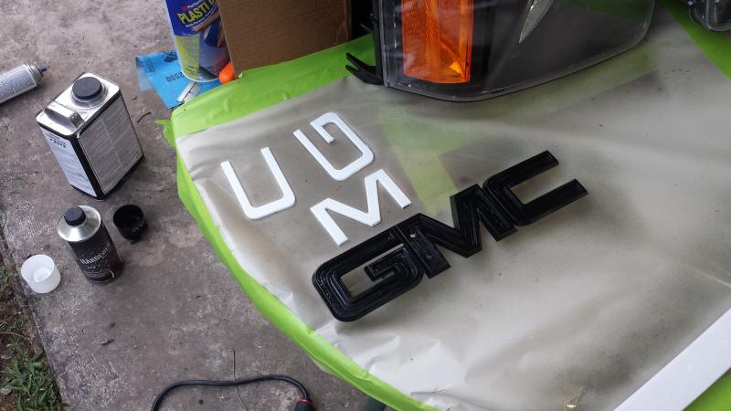

also working on acually painting the grill shell, i had it plasti dip painting the shell and the gmc emblem white to match

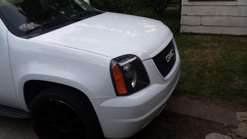

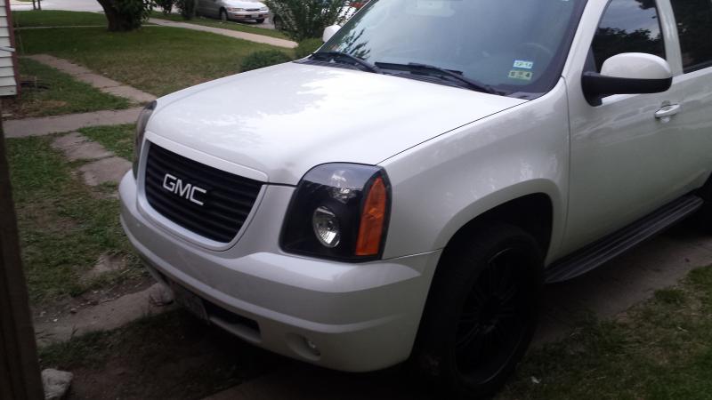

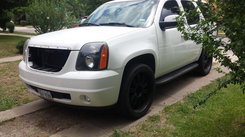

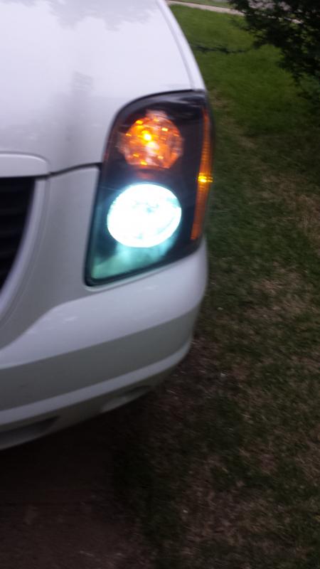

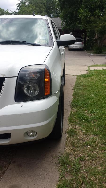

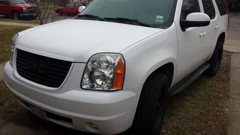

i finished and cleared the headlamps,and the grille. im wating a week so i can cut and buff the headlamps but im happy with the results.. need to touch up the plasti dip on the wheels
---------- Post added at 10:02 PM ---------- Previous post was at 08:46 PM ----------
hope fully i can get better pictures soon :)

looks great, almost appears to be dark tint but not so. Still have original light out put. Good job.
How tough was it to split the lens from the back?
07whitekon
07whitekon
May 19, 2014
14
dallas
Thanks,Yeah look tinted but I don't like the smoked look on white cars, to be honest with a heat gun I felt it was really easy, we'll for me it was and it probably to me 5 min or lest to open each one up
