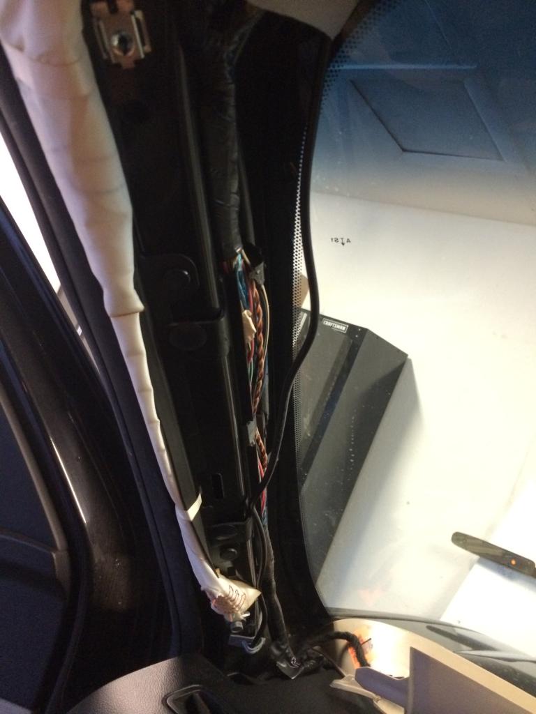

Remove the A Pillar cover
![CE38E5D5-075D-4ADF-AFFD-1074F231C19E_zpsyc8lbzar.jpg CE38E5D5-075D-4ADF-AFFD-1074F231C19E_zpsyc8lbzar.jpg](https://www.tahoeyukonforum.com/data/attachments/152/152461-b01c060d3b3633ca30c3bb4c28b57aa2.jpg)
Pull back headliner and tuck, it's not coming out if you pull the headliner back far enough, but be careful

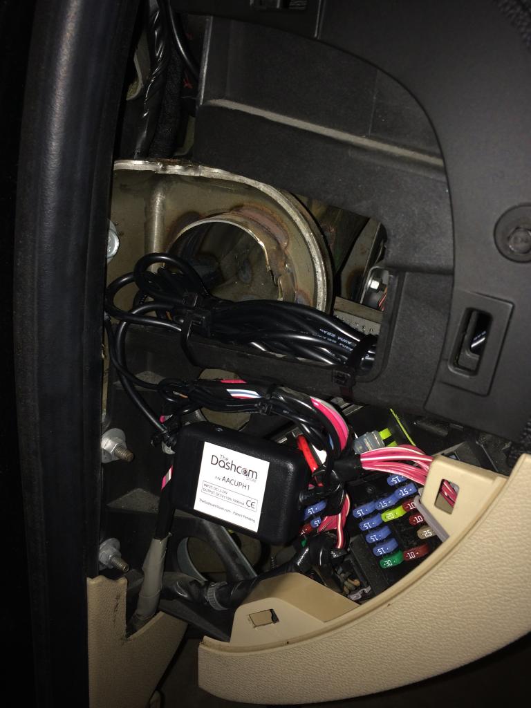

Then clean up the wiring and close up the fuse panel:
![8622E235-44CA-44BC-B9F7-9721ED7C00CA_zpsd9ycxqe7.jpg 8622E235-44CA-44BC-B9F7-9721ED7C00CA_zpsd9ycxqe7.jpg](https://www.tahoeyukonforum.com/data/attachments/152/152464-2ded2c5f0f5c36b69154f09baa41d5bc.jpg)
