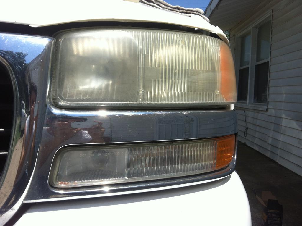

While I wait on getting new headlights, I wish to fix/clean the current ones up a bit. What is the best way to do this?

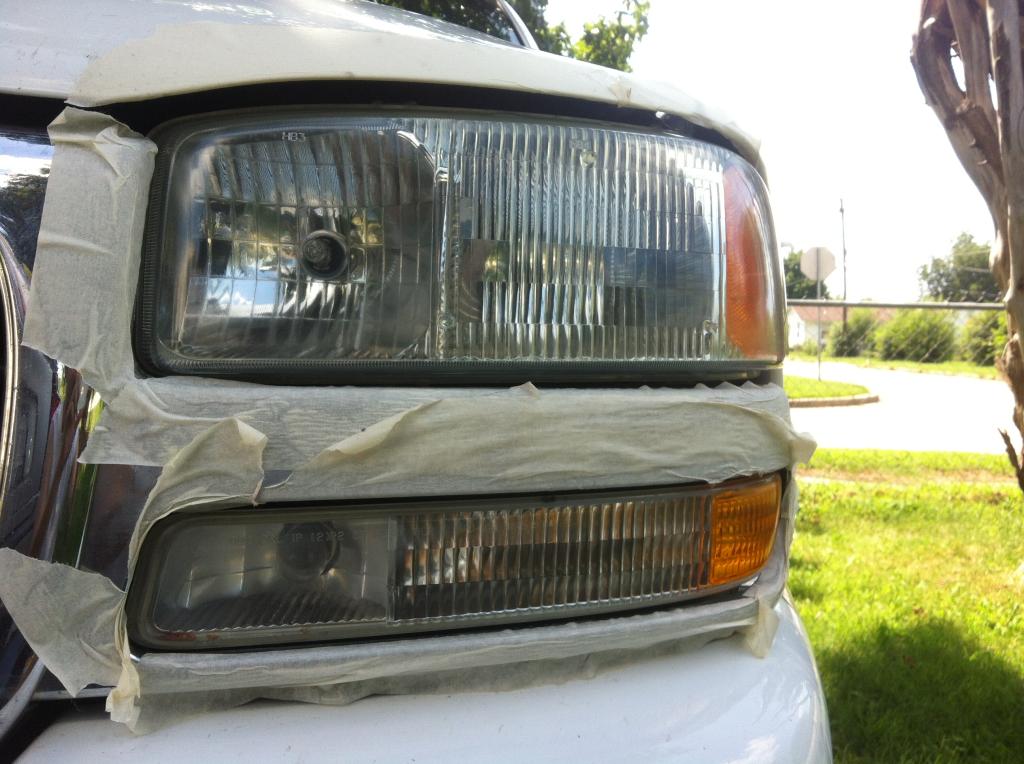

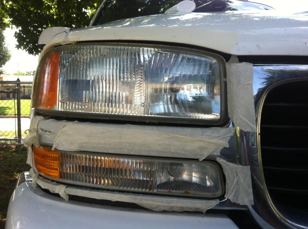

i also, wetsand then extensivly untill all of the oem clearcoat is removed.
as you wetsand them (use alot of water) dry them off from time to time so you can see if the oem clear is removed completely.
Once its removed grab your buffer, start with a heavy scratch remover. work the lenses until all of the 2k marks are removed and you have a glass smooth even finish.
Follow up with a polish. this will turn them crystal clear.
Takes aprox 30 mins per light.
This will give you time to find you a set of denali projectors, PM inc on where to find them.
After the 2k wetsand
After polishing
After polish, as you can see the blinker need alil more wetsanding.
