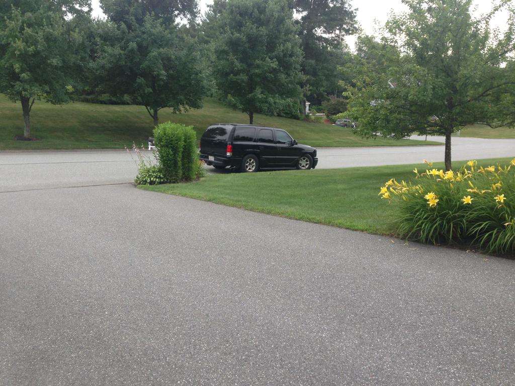

Even tho i like low i want truck to be level it looks like the back of the truck isn't even lowered the way it sits.

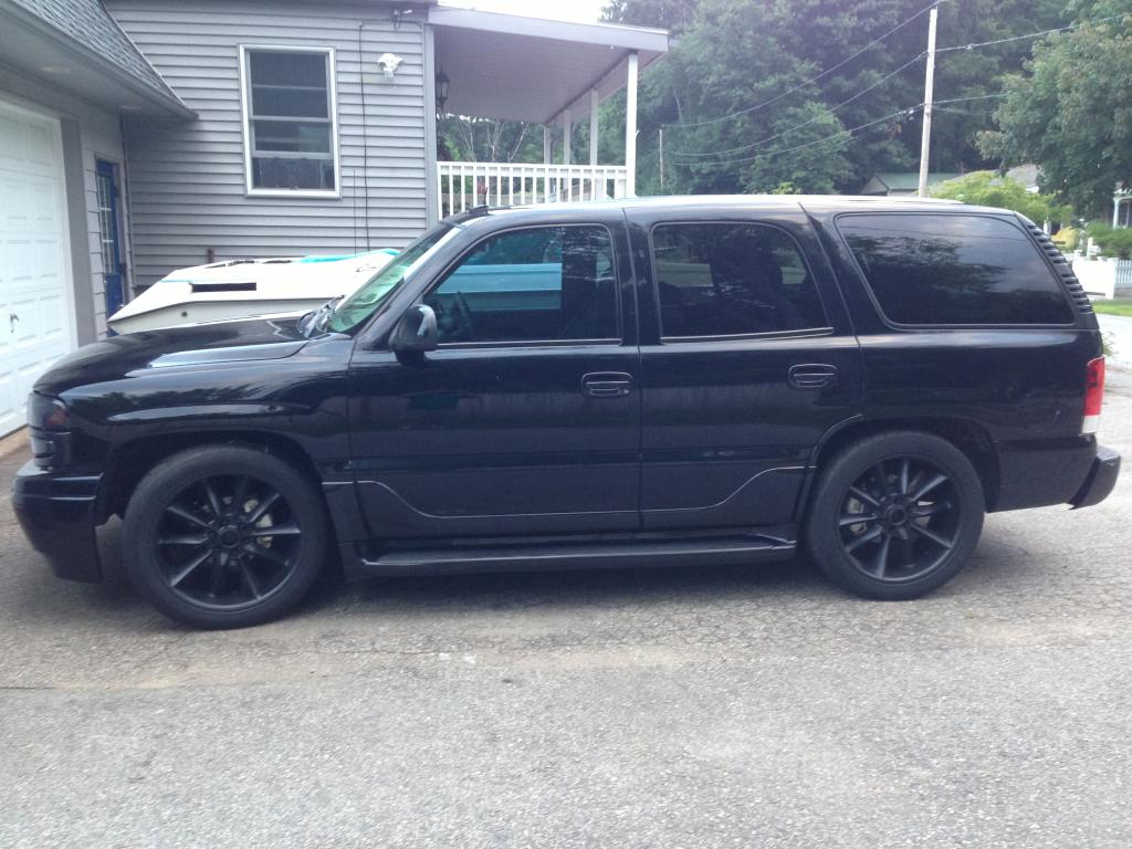

Im VERY HAPPY i solved the issue and did the conversion, it handles great and the wheel just feels smoother and easy to turn. I have a little more dialing into do and get the correct ride height. I will post up more results and updates as i changes things.
Also tossed my 22's on, this is pretty much how she sits now. lowered the back a little since.

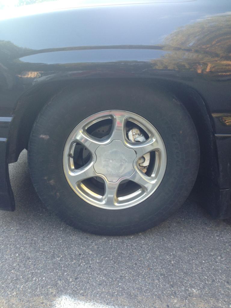

I went for alignment the next morning. As i was in the parking lot i knew they were not going to be able to fix my camber due to the fact if they pushed it out the tire would be hitting the inside of the fender. My toe was messed due to having a gear box and pitman arm installed. Toe fixed and cambers at -4ish at the moment. So lifting it with the pro comp i should be able to align the camber.
IMPRESSION
So to start my buddy that owns the shop and hung out while I did the swap was questioning it working. As he stated in his automotive knowledge and thinking that the parts I had would not work with my truck. As in to small of a shock and spring. I told him to hold on and watch.* So I finished and I asked him if he wanted to go for ride in his 1st coil over Nali. I had the shock set to the 5th click as I didn't know what to expect and had truck sitting at 30 3/8.* We went for a mile ride and I was impressed with ride. Even my buddy noticed a different and was impressed how the conversion worked out. Bumps were smoother and not as jarring. My nali is awd so on full lock turns the front would ratchet on its self now with the swap she turns crisp and clean at full lock which is nice.
The next morning I re measured the truck and it was 1/4 off from settling. As I mentioned before driver side is way up on threads and passengers side isn't. The truck was low so I cranked the coils a full turn and a half and went to setting 6 on shocks and went for a alignment. After alignment it rode good with toe fixed.

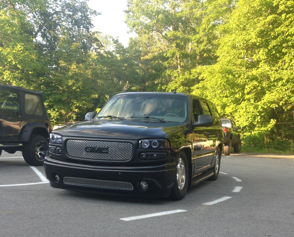

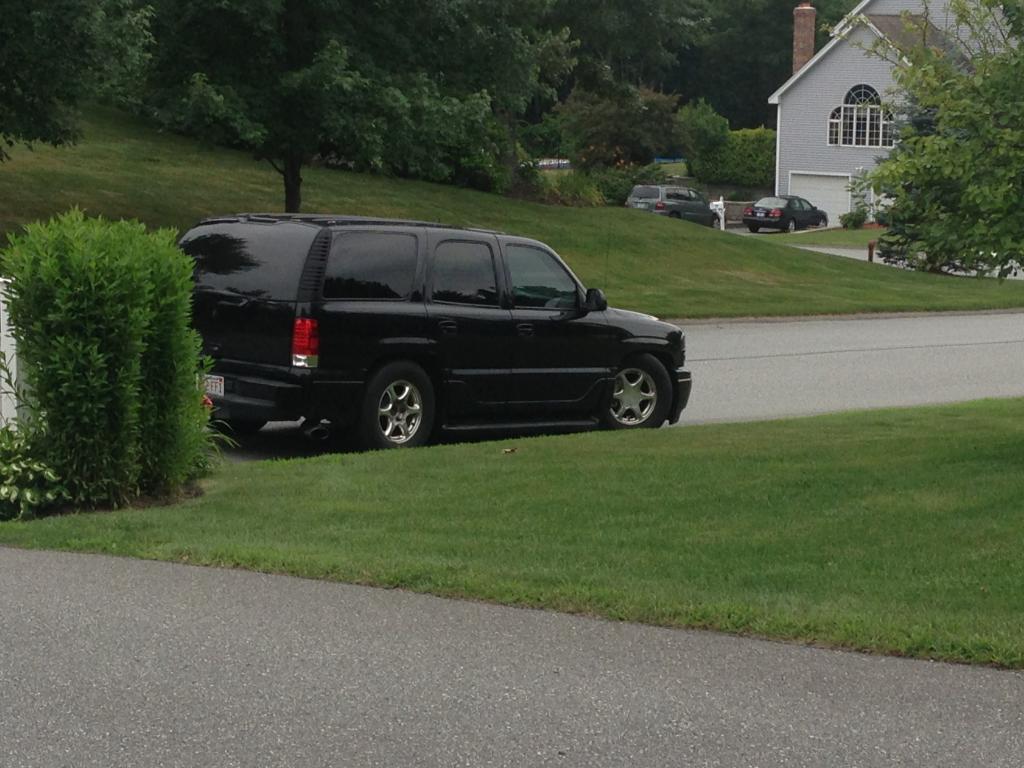

Beside it being lower then I thought it was going to be I'm 100% happy I did the swap. The ride has improved over the T-bars. I was looking to get rid of the jarring over bumps which has improved a bunch I believe once I raise it up a bit it will ride even better and I can fool around with the shock settings.
Digitalfiend stud top washer and mount doing work
Minute i pulled it out of the shop
