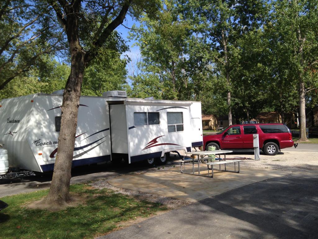

Just a quick update that we just towed the 200 miles to the campground with no issues. Towing my trailer is where the truck would guzzle oil. Now, sitting at 700 miles since last change, oil level is still full which is great.
Also, the truck performed great. This is my first time towing with the range delete and throttle response is much better. And I may be just imagining this but it feels stronger. I am hoping that oil is no longer being ingested via the pcv and that the motor is gradually burning off the crud.
Just for reference, here is what I am towing, so it's not just a little trailer.
Here is how things looked about 2 hours in to the drive. Note the temp gauge is rock solid at the normal mark. Low 80's outside temp, and the truck used to run hotter than this. Maybe another side benefit, I don't know.
