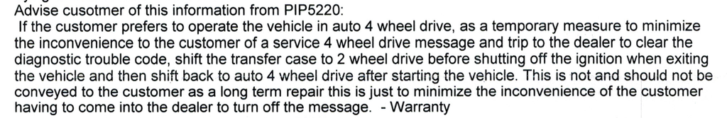

Here's some info the GM service center gave us for suppressing the 'Service 4WD' message in the dash if anybody's interested. I don't believe it'll get the truck out of 4WD, but at least the dash won't annoy you while you're tires are screeching and your truck is crabbing with every turn.

Our Denali was serviced Friday and we're now back in 2WD. Hopefully the real fix comes prior to our snow falling. They said GM had a 'preliminary investigation' and a full recall would be issued shortly.
If it doesn't bring the truck out of 4wd they should not even issue this recommendation to owners. Some will consider that no message means everything is fine while they are tearing up their $70k SUV from the inside out driving it in 4wd on dry pavement.

I picked mine up yesterday and was given the above mentioned memo from GM on the problem. It has been given a case number with GM, they are working on a fix that will be implemented as a recall. Good news is, the problem is being addressed. Bad news is, there is no time line on the fix. Currently there is no fix, only the work around described in the memo.
