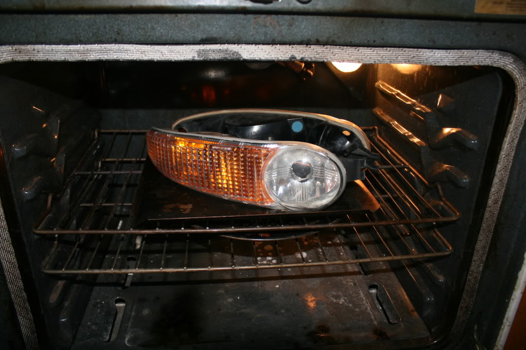

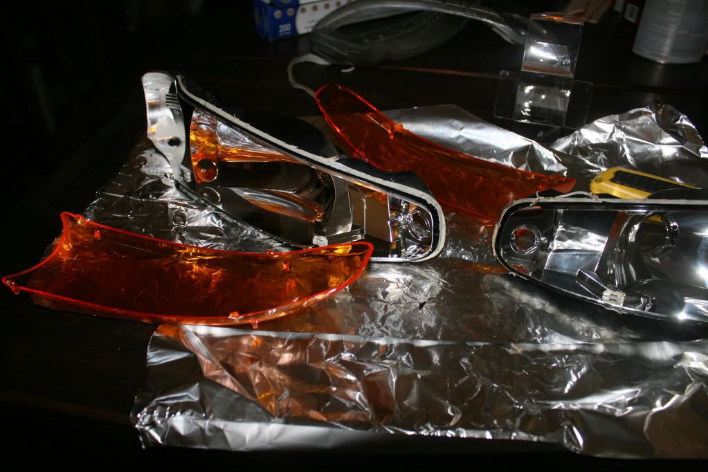

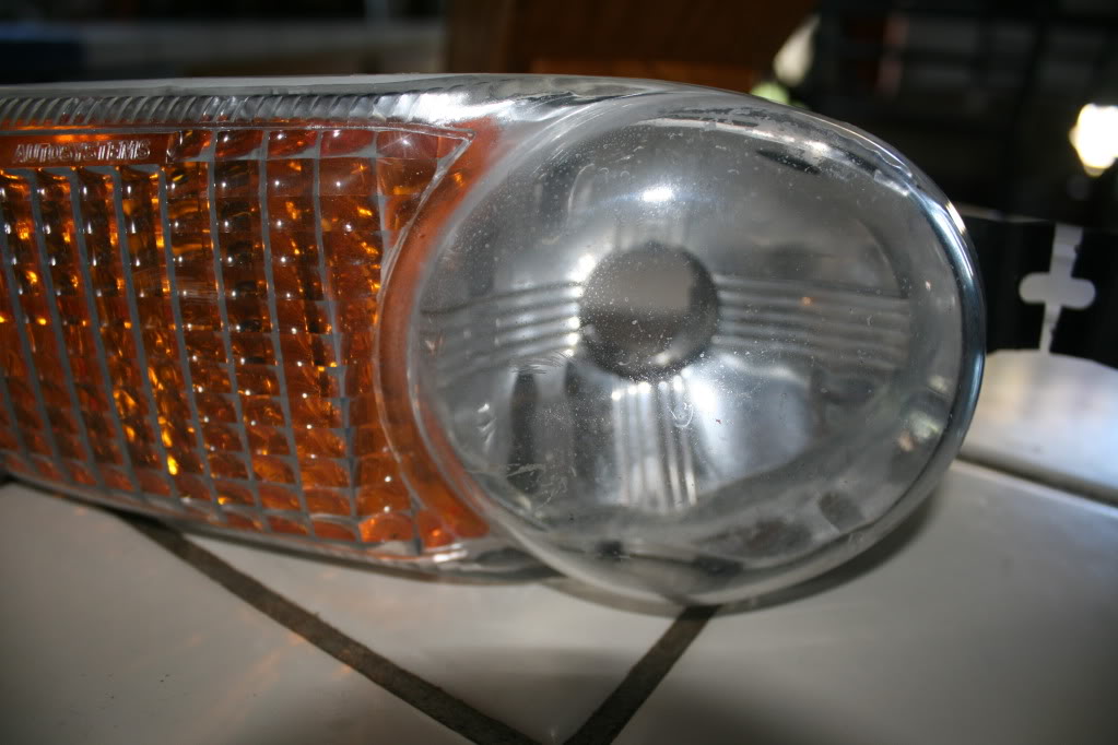

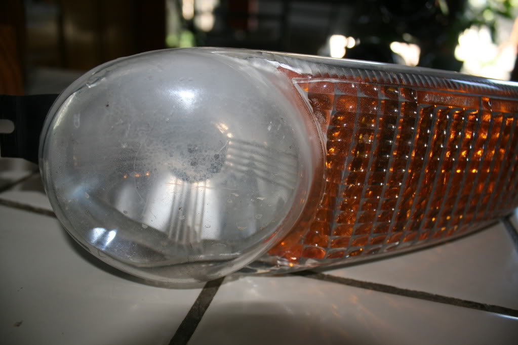

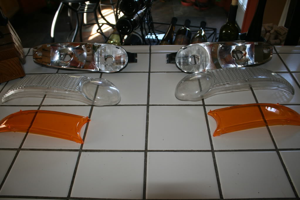

Remove Corner Lights from truck
Pre-Heat oven to 250 degrees
Place empty Corner Lights (NO Bulbs) into over for 15 minutes
Remove Corner Lights from oven and use a razor to cut the silicone as gently prying the clear lens off the housing (leave oven on at 250 degrees)
Once you have removed the clear lens, put the housing (without clear lens) back into oven for 15 minutes to heat the silicone holding the orange lens

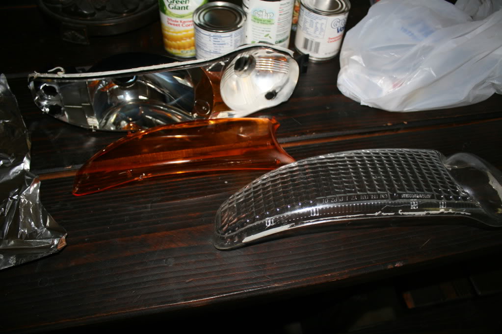

Remove Housing from oven and pry the orange lens off the housing (this is very easy!)

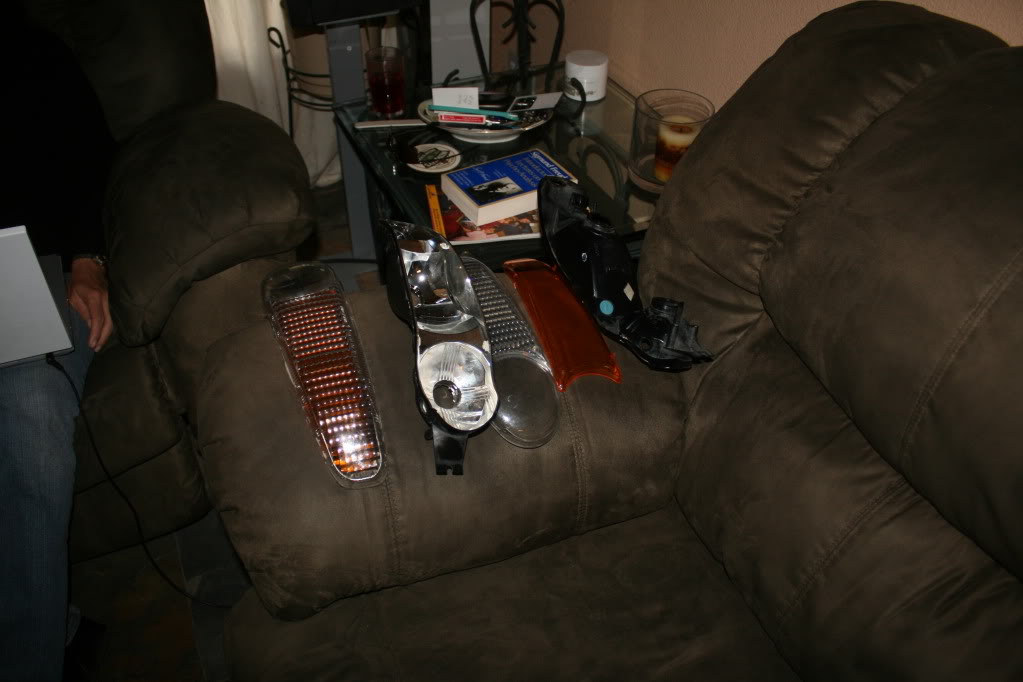

This is everything taken apart

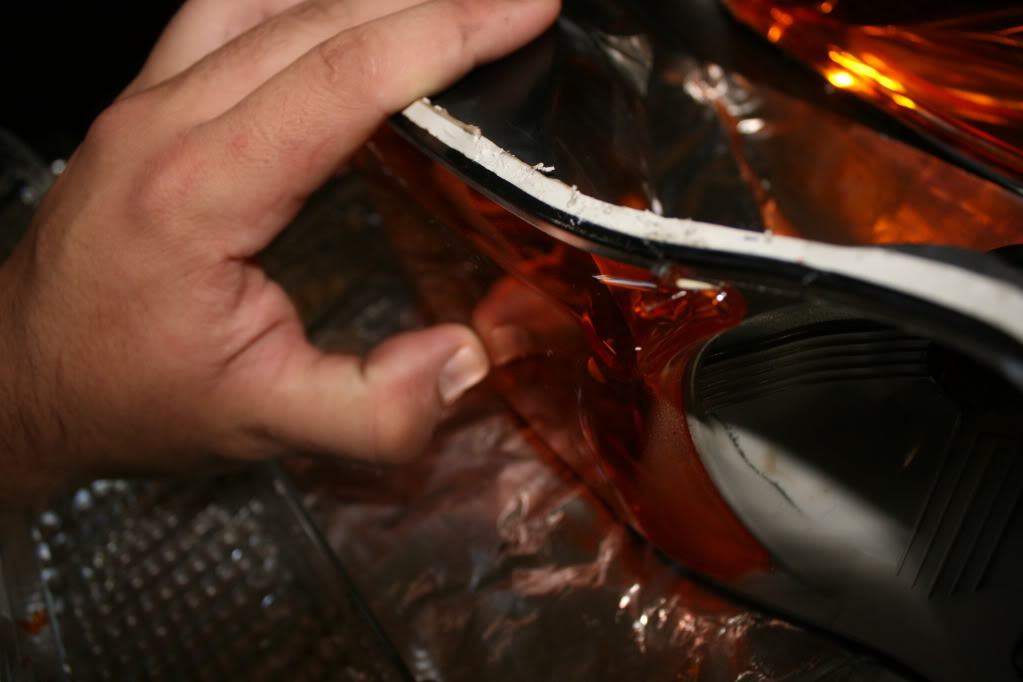

(I put the housing back into the oven after everything was taken apart to heat up the silicone, around the edge making it easier to remove it all...I had to put it in multiple times because the old silicone gets cold and hard real fast making it hard to peel off..when its warm though, it peels off like tape!)
I do NOT have Re-Install pictures as I have not put them back together yet! All you need to do is put a line of silicone around the housing where the old silicone was...make sure its a solid line with no holes or breaks...this will keep your lens weather proof!

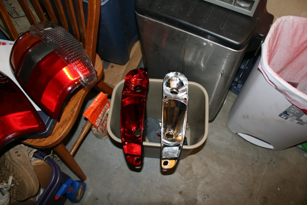

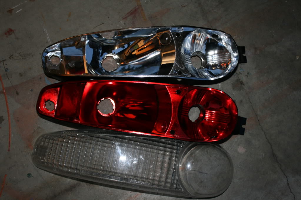

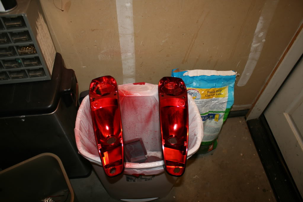

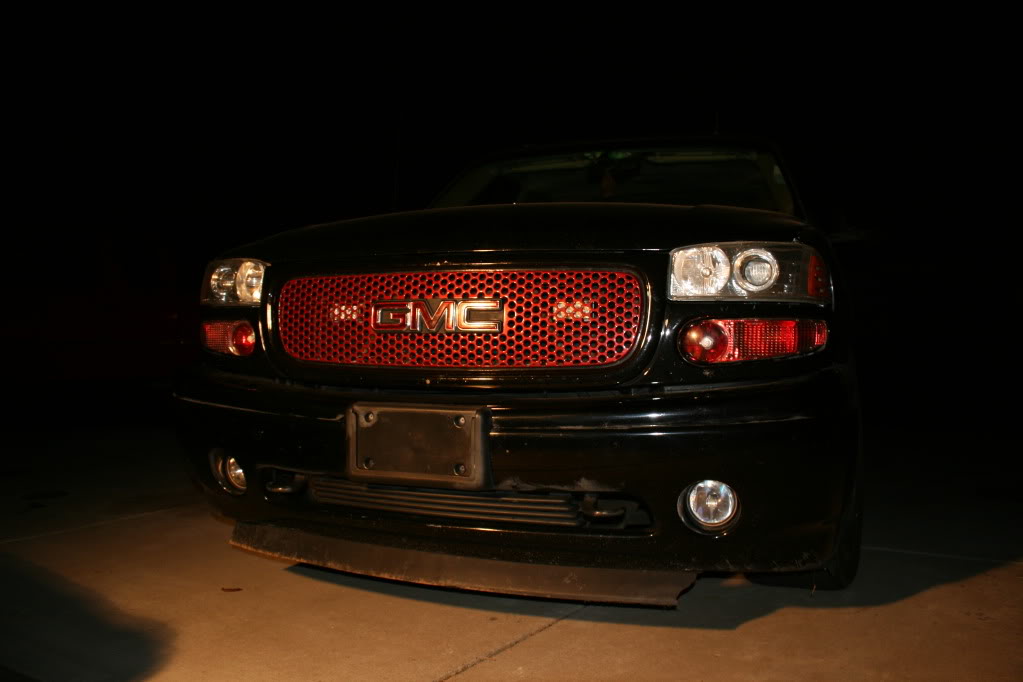

Clean housings with alcohol (WARNING: BE CAREFUL!!!! If you rub too hard to too much, you WILL rub the chrome off...and then you'll have shiny black areas!!!)
Painting the housings (DONT go wild...spray 1 or 2 coats and let dry for bout 10-15 minutes...then spray more coats and dry time as needed)

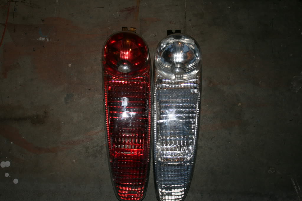

Comparing both

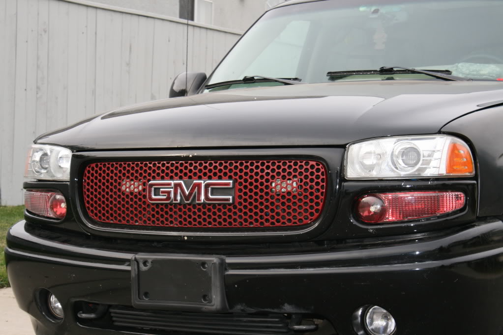

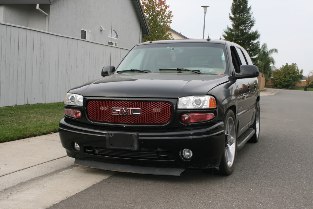

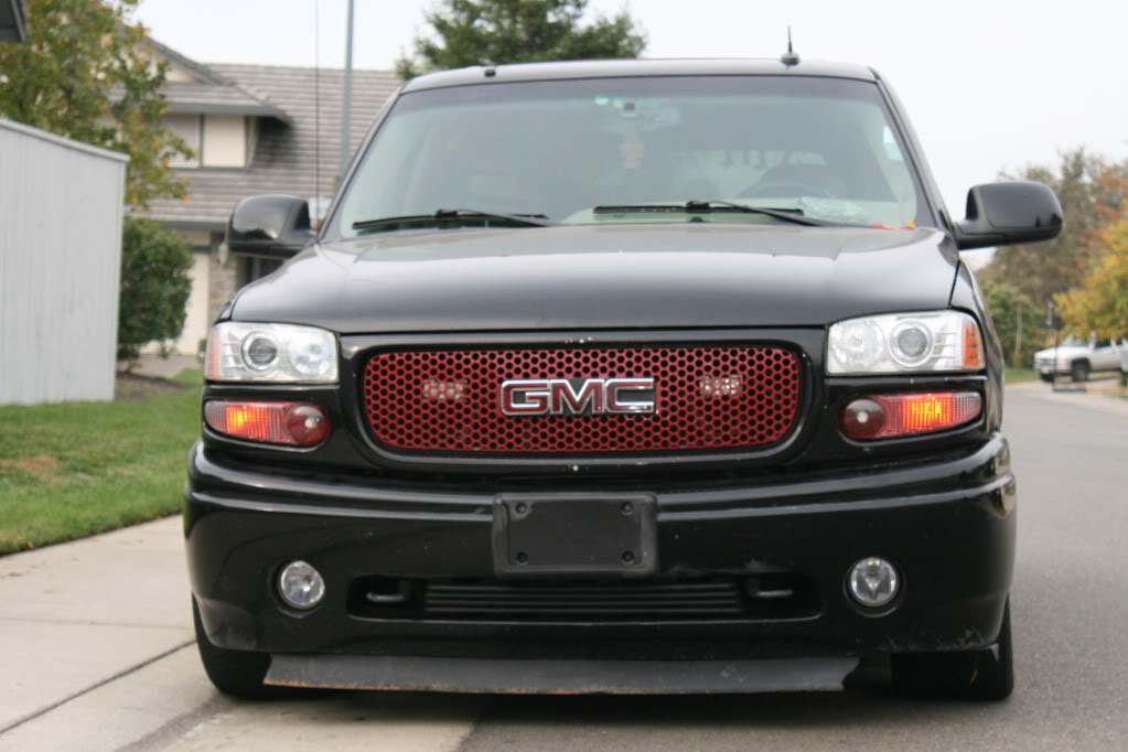

Both housings on the truck

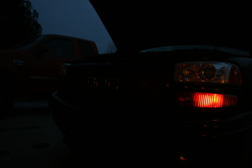

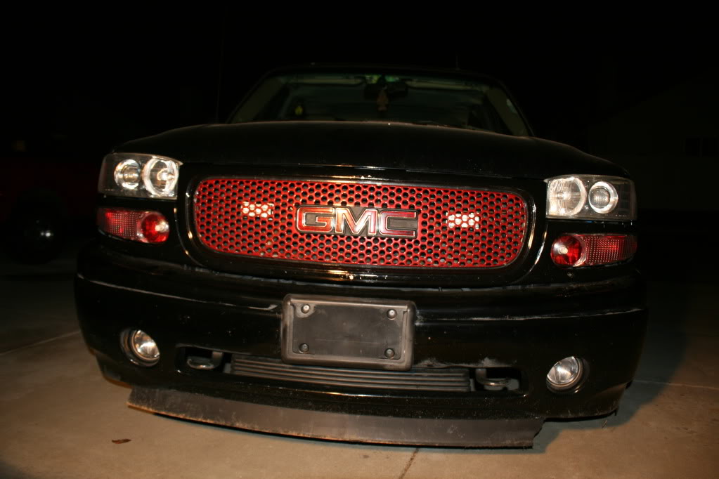

Making sure blinkers do NOT emit red light...blinkers are still Orange
Painting 2nd housing

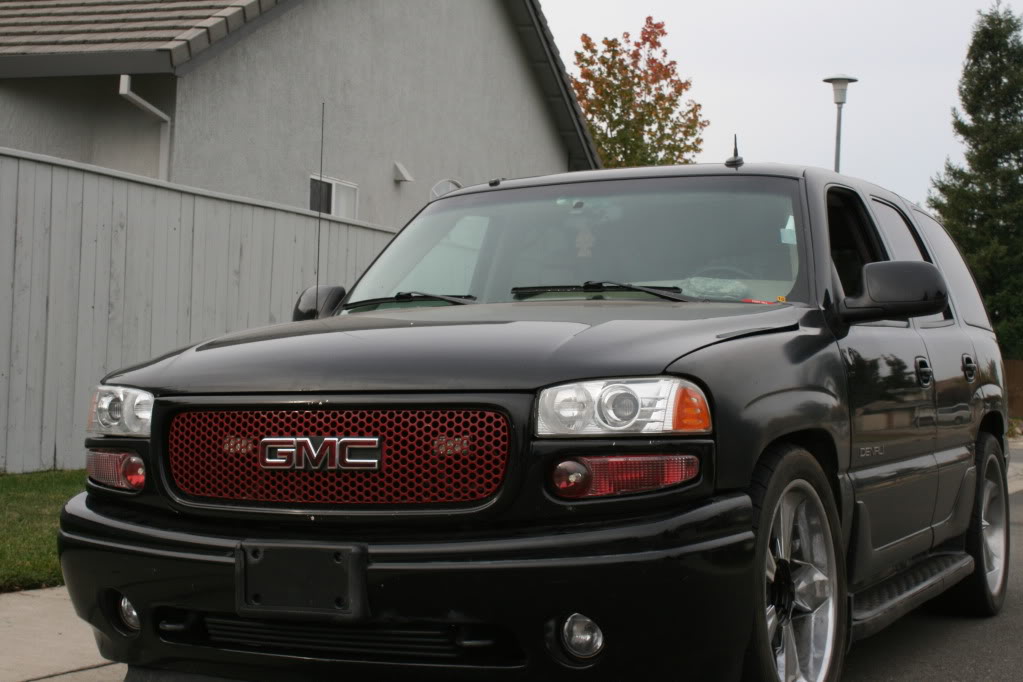

Final result at night with red-chrome housing
