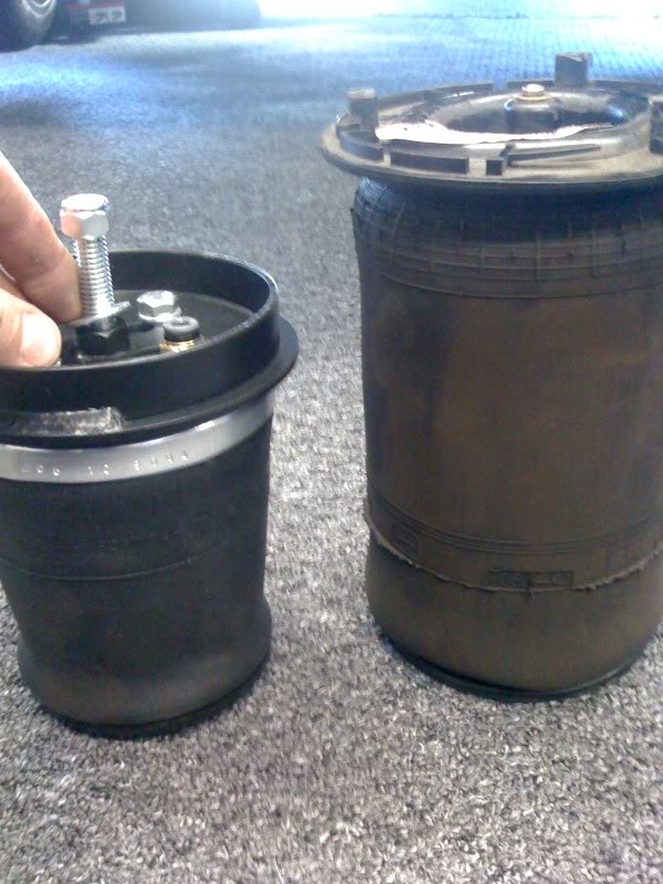

do yourself a favor run the trailblazer ss airbags.
Sit lower than other brands out there at ride height
can tow 6500 pounds
and only 150 bucks
bolt in deal
from my old post...

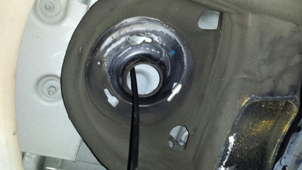

Well this has been going on for a while and its a hit or miss on the trucks and today did a 07 and a 09 (posting pics a little later) and BOTH have the notches in rear for the trailblazer ss airbags. So if any of you guys want to airbag the back of your 07 up gm suv just check to see if your oem upper mounts have these 3 slots. GM used the same brackets for the trailblazer ss as the tahoes and vise versa. All you would need to do is get a 06 up trailblazer ss airbag kit and a 5/32 hose which connects to the trailblazer ss air bag then run a 5/32 to a 1/4 inch adapter and your set.
You can get trailblazer ss airbags for about 150 new from ebay and the fittings are cheap.
Now when installing these airbags ride height is about a 2.5 to 3 inch drop on the 07 up tahoe and then you can let all the air out and the axle will sit on the frame. You will need the djm links and my bumpstops which are 110 shipped or you can do the djm hardware kit and my bumpstops and they are 190 shipped that way you can slam it.
If you guys have any questions feel free to ask.
Here is a pic of the upper bracket on the tahoe which makes the tbss airbag a bolt in deal
on the right you can see the trailblazer ss airbag ears up top which spin right in
