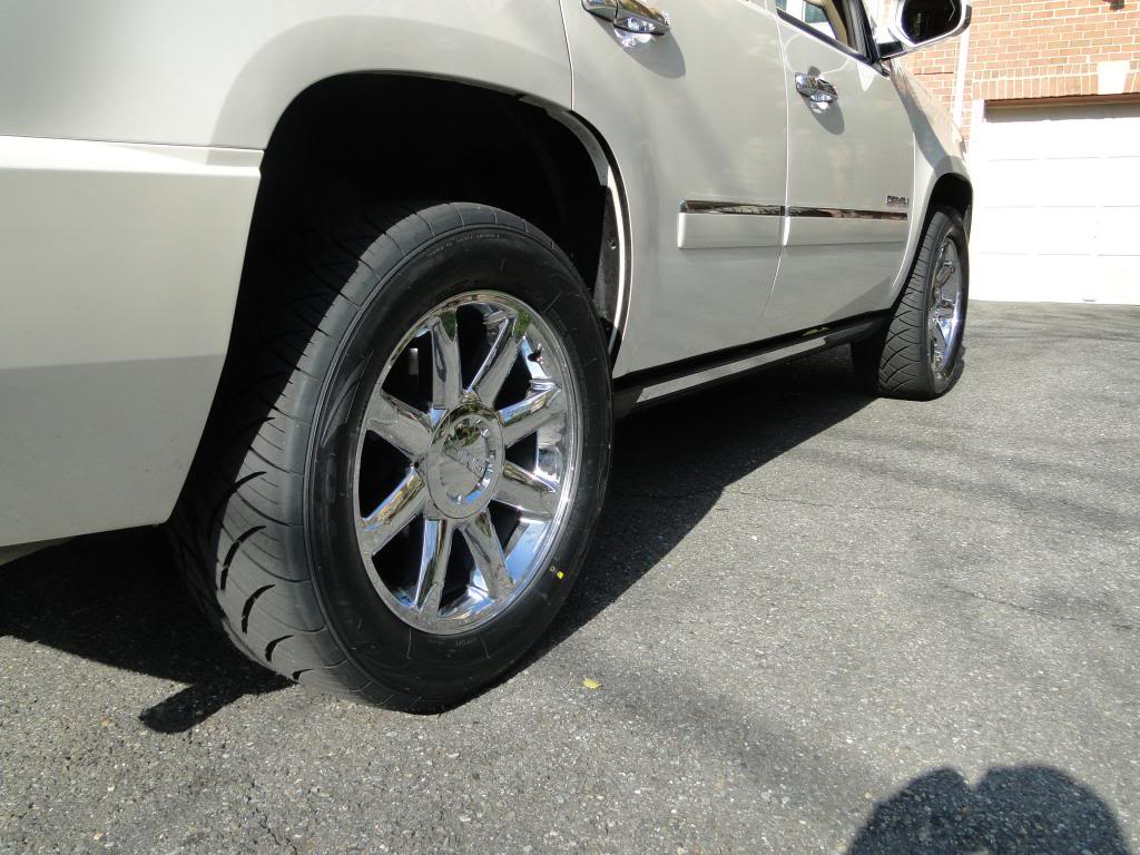

Nitto 420s 305/50/20 (aka moon landers) factory ride height:
No trimming required, tiny rub when turning into high angle driveways and the truck was at full lock and very pitched ... we're talking almost never. Would get more rub if they were A/T tires.
