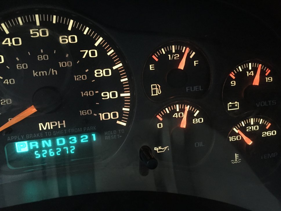

High oil pressure once again. With 526k miles this is the most extensive "tearing" into the drive train I have had to do, other than a 2-3 shift solenoid going back in the transmission a while back.

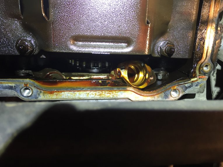

I am not sure why the one of the engine's crank case/sump area is upside down but whatever. The 2nd photo shows you where the oil pickup tube bolts to the bottom of the oil pump. Pretty straight forward fix.
