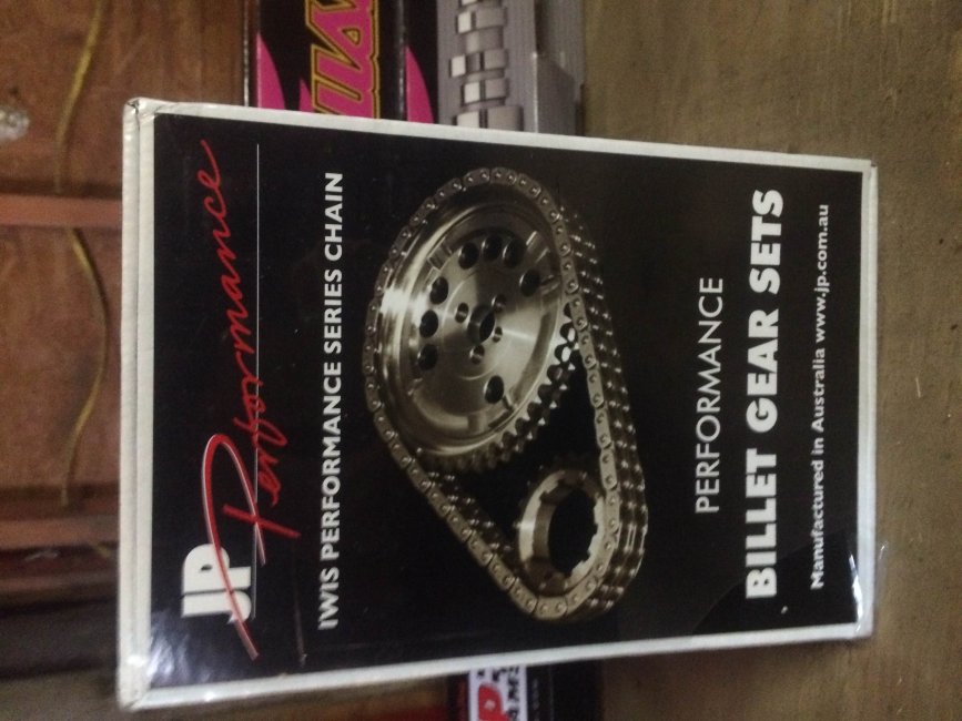

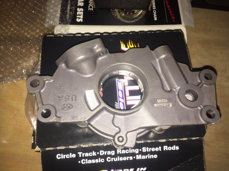

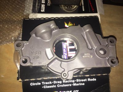

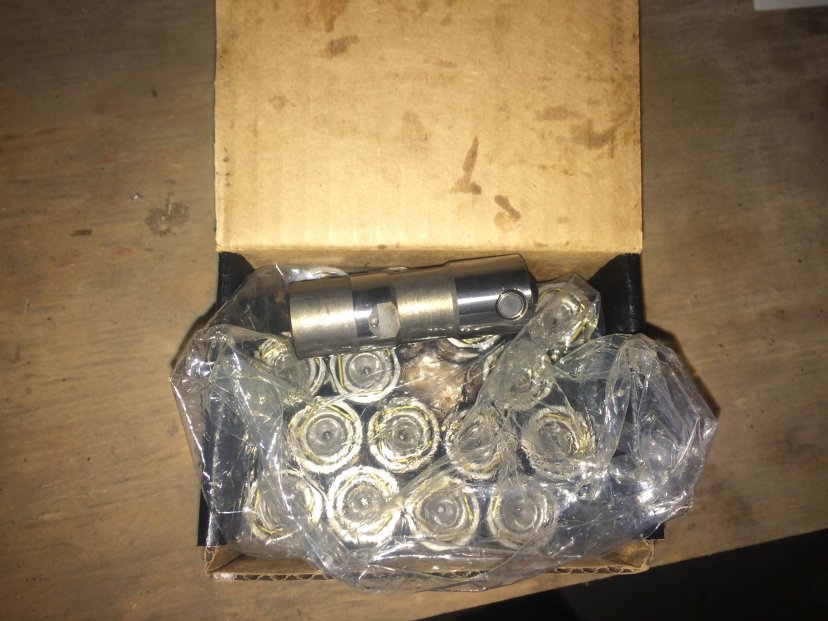

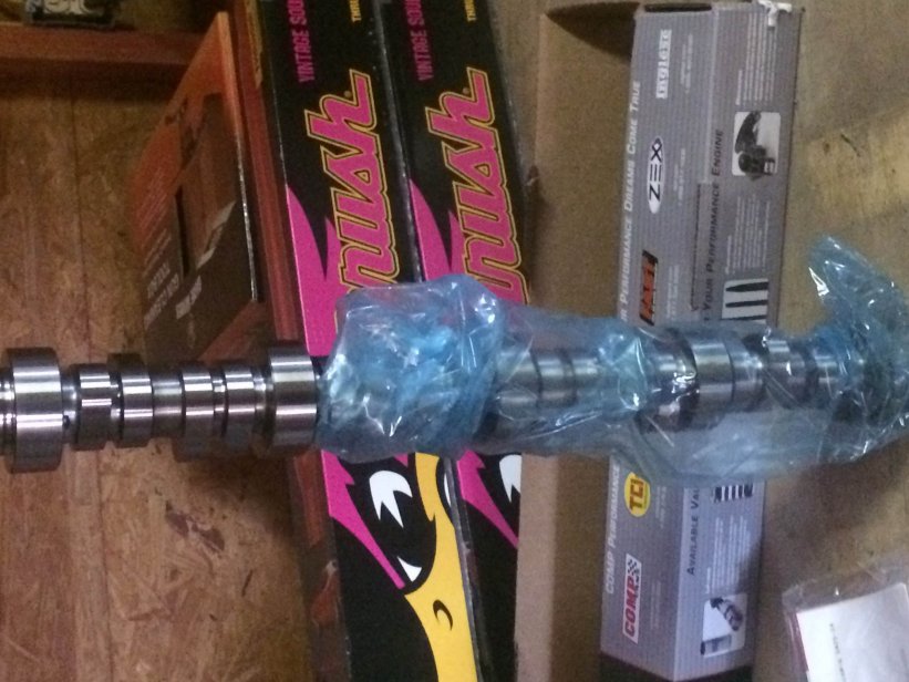

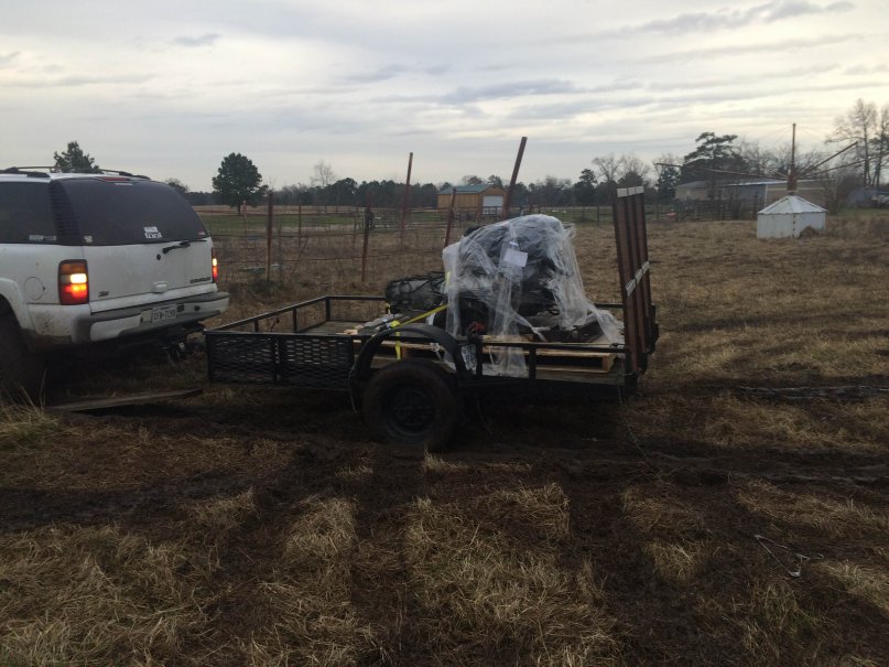

Look what came while I was at work!
Brain Tooley Racing is the place to go!

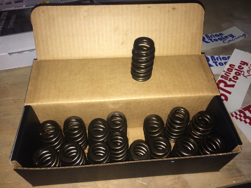

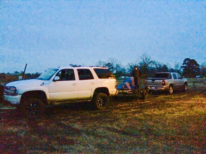

More stuff
Heres some more!
SunlitComet
OBS Jedi-Do Good
Sep 30, 2010
16,206
188
unknown at this time.
High pressure/volume pumps on an engine such as a street factory engine not built for track racing can cause so much pressure that the bypass valve will do it job so much that it can heat up the oil and likely cause aeration of the oil. Neither of those is a good thing.
TxDrewski
TxDrewski
Aug 2, 2013
495
19
Potomac,MT
Ahh okay. I had assumed that with a catch can and larger oil cooler I may need more than normal amounts of pressure I'll contact BTR, thanks Sunlit.
