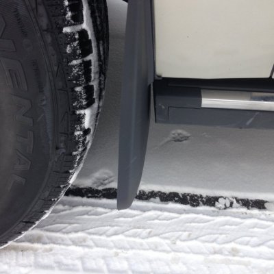

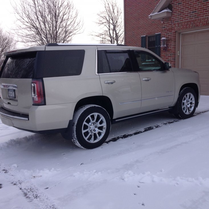

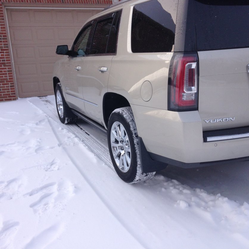

These are the ones that work.
They mounted up in existing holes using the stock screws, and without taking the wheel off as long as you have a torx socket (short to fit between tire and flap) the correct size to reach the inside screw. A regular torx driver won't fit in that little amount of space.
Although this pic shows my wife's truck with the winter 20" wheel set, there will be plenty of clearance when we remount the 22" wheels and tires for the summer.
