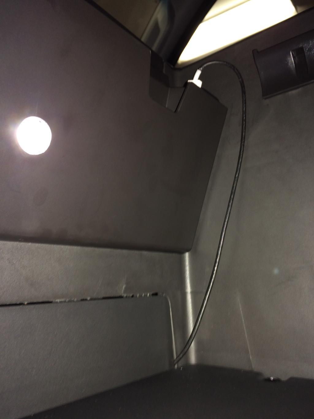

Since Apple does not make a black Lightning cable, and I was reusing a cradle from a past vehicle that required the Apple cable, I picked up a can of black PlastiDip and sprayed the cable black so it would blend in.
I pulled the rubber floor liner out of the center console and then removed the 5 screws to remove the bottom panel to allow access to run the cable
By pulling up a bit on the edge of cup-holder panel I was able to insert the USB-end of the cable and fish it down where I could access it from the removed center console panel. I had planned to cut a small notch in the edge of the panel for the cable to come through, but there was enough play in the panel to secure it back without needing to notch.
Finished product.....
