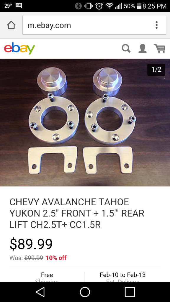

First off this kit was from Summit Machining on eBay. It was on sale for $90 for 2.5'' front and 1.5'' rear. The front offers an upper and lower spacer, instead of one giant spacer up top. I like how it adds a little on both sides, in a way that keeps the strut centered.

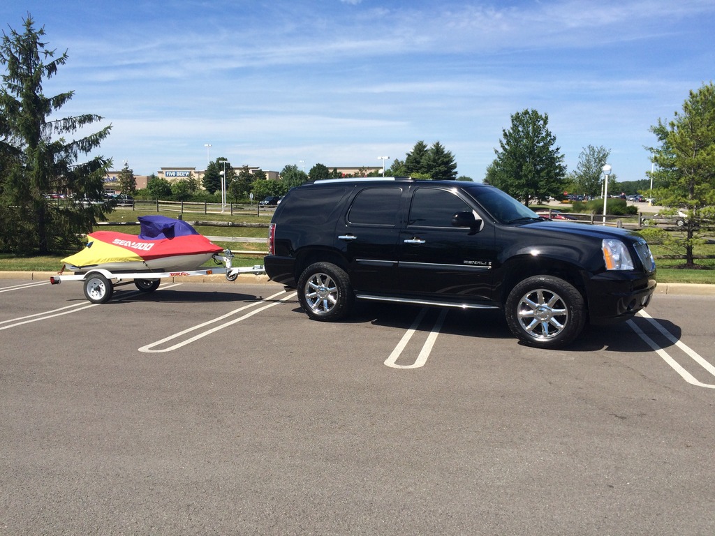

All in all this took about 2-2.5 hours and was super easy. The lift may sound small but it made a huge difference and I love the way it sits. Not too big but noticeably "stout" compared to stock. Stock size tires look ok, but going up a size or two will make the truck even bigger.

Before:
Finished product:
