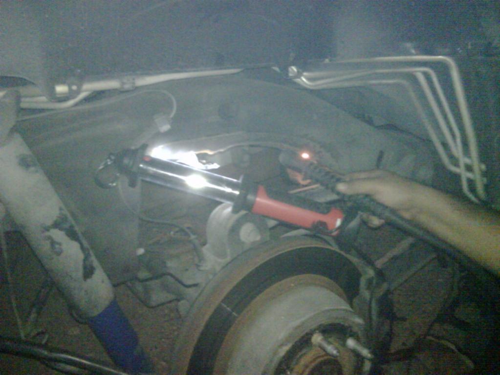

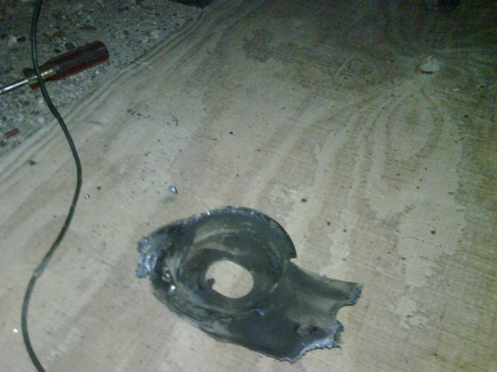

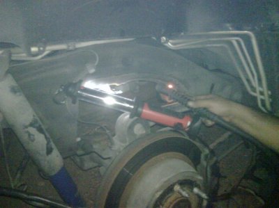

sorry been away for a while. i stiil have a few retsaurants to run so i have been very ocupied thank god. the trsuck is still on jack stand and the bump stops are gone., but i decide to go aheada and install a compressor and valves. so i should be done next week, i hope. also the weather in south texas has been very freaking cold. here are some progress pics.
warning. you will have a lot of issues with the left side,due to the gas tank being less than a 1/8 of and inch from the frame. we had a plasma bt had to finish with a cutting wheel.
