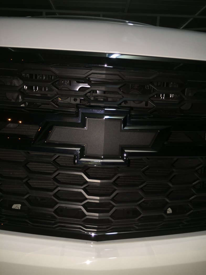

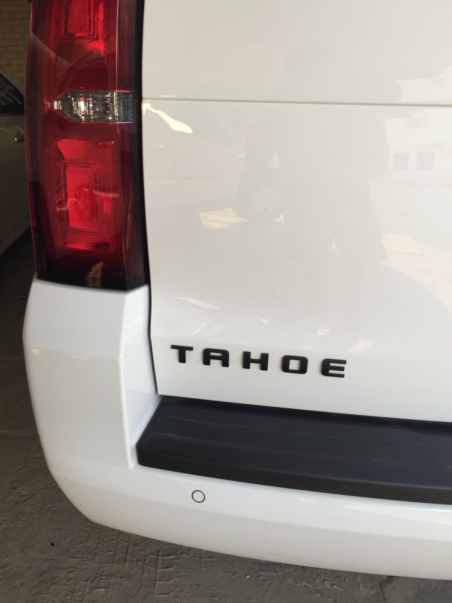

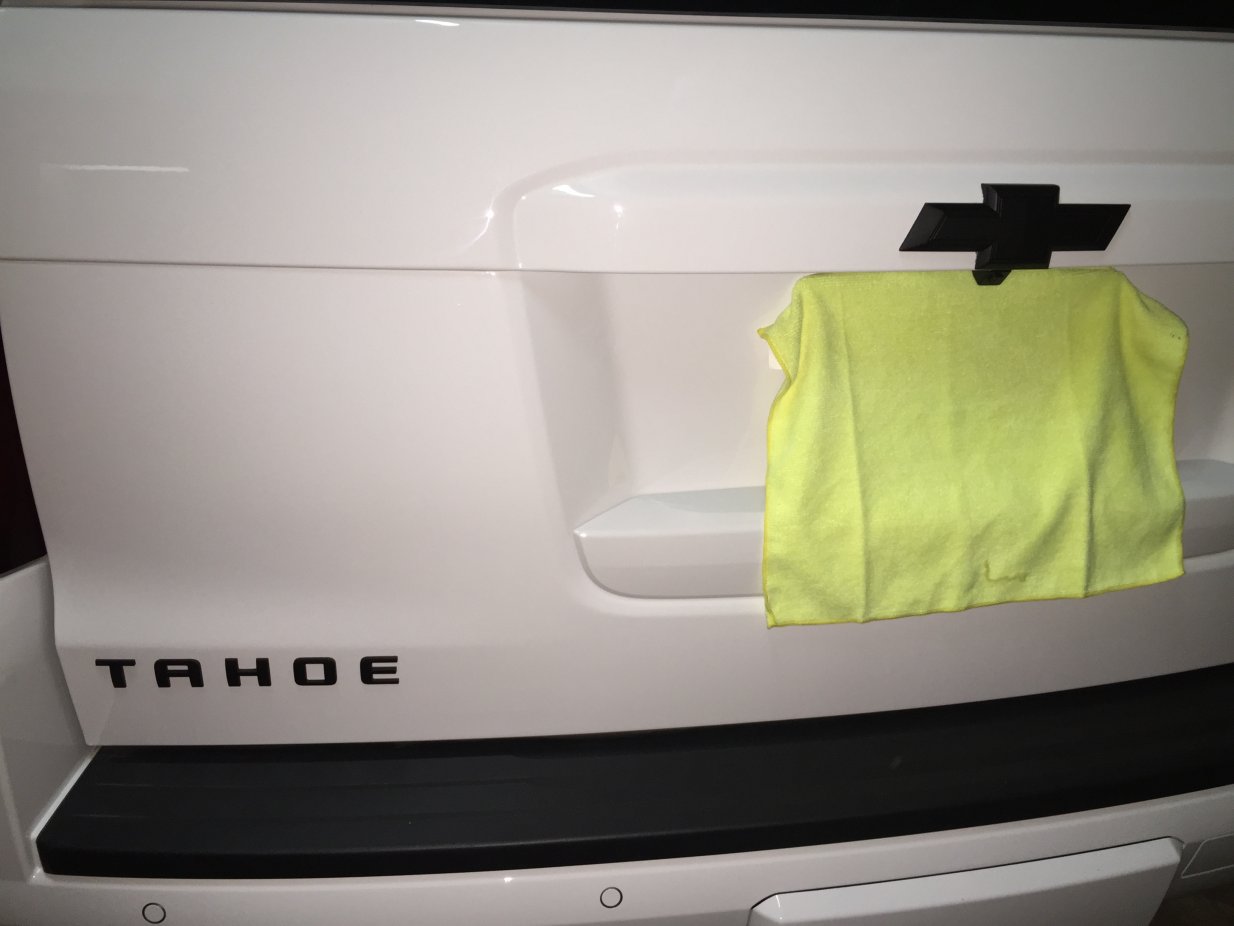

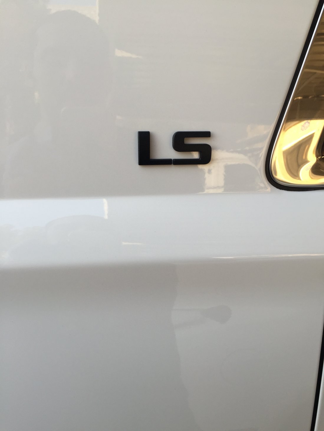

My brand new tahoe arrived 2 days ago and i decided to go plastidip my emblems to black... also gonna plastidip the wheels, window trim, grill and taillights.

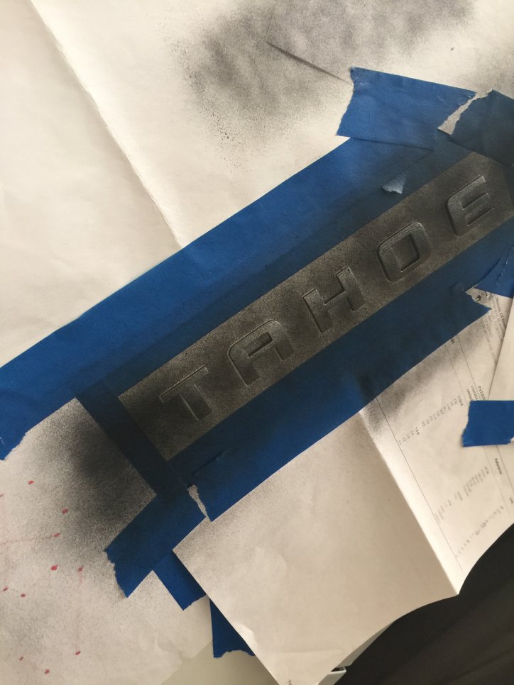

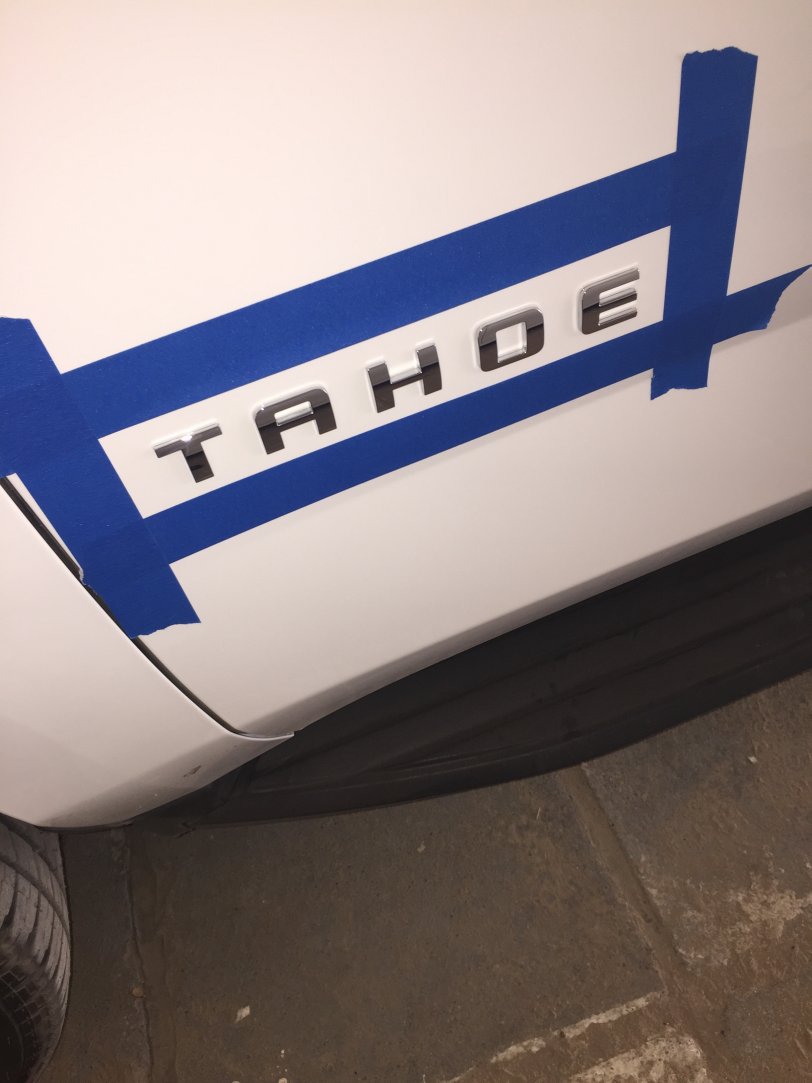

Do you have any photos of how you taped everything off before applying the plasti-dipped the Tahoe and LT emblems? Or did you not even bother taping anything off and just sprayed and then removed from the paint?
hosseface
Mar 20, 2014
794
107
You'd want to tape off a square about 2" larger than the perimeter of the letters and then use some plastic/masking paper for overspray. Otherwise, you'd never get it cleaned up to look good. Also, lay it on heavy inside the whole area you masked off. After it dries, remove the tape/masking paper, then peel it off any unwanted areas.
S
SkyWalker
Jul 13, 2015
22
Here you go...
Just make sure you spray enough coats... 4 coats is enough to make it peel easy
