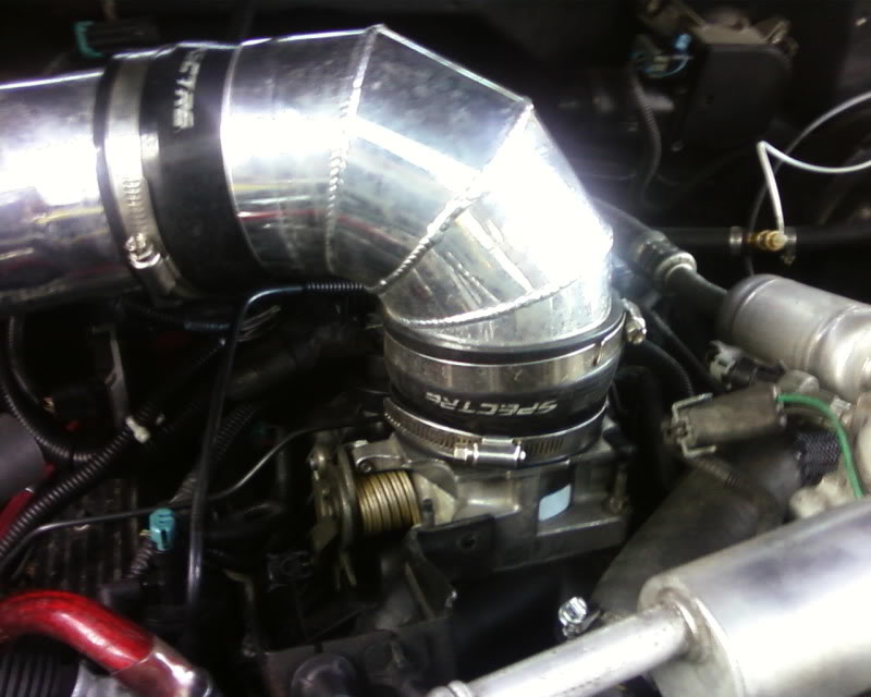

if you have the means to do it you could probably switch your intake piping to something like mine and get some benefit, but i wish i has a way to separate the filter from the engine bay heat. but its to cold to do it right now
here are some pics for inspiration
hope this helps.
hope this helps.
i was thinking of getting the same elbow for my CAI, what did u do with the little hose that goes from the passenger side valve cover to the stock intake tube
im glad i see someone with it now, so i know it clears the hood
