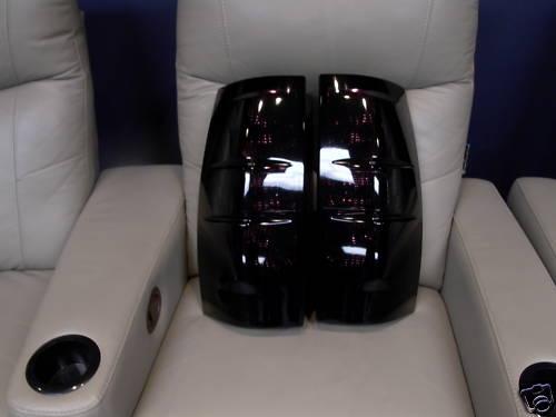

Yes you can use this for tail lights or any lights. I done the same process for all my lights, however the last set of lights that I done I used the areomax clear:Handshake: Here's a picture of my stock tails that I used to have, I've since sold them and tinted some LED tails. Gotta get some good pictures of them.

DW those are beautiful tails. but one ? the seats those are on they look like really nice movie seats so i am thinking that because ur tails r on them you might have a theater in your house. looks good
