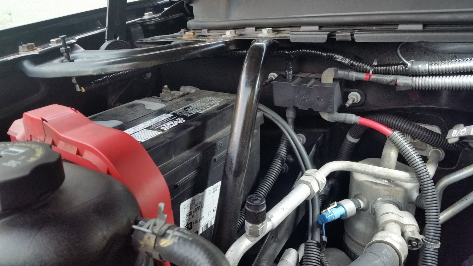

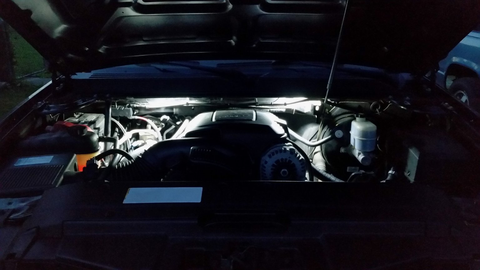

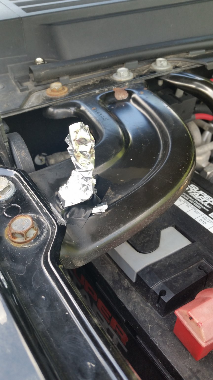

The under hood light install went easy. I started by locating my switch. I used tin foil to set switch height. 20170414_165121.jpg
Then I closed the hood and measured the height.
Then removed brace and installed switch.
Then I built my wiring harness. I tapped the power from the junction box by the battery.

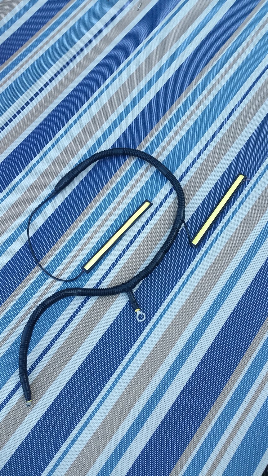

I couldn't get good pics of the reverse lights, but that install was pretty easy. Probably will add 2 more LED strips under the hood at a later time.

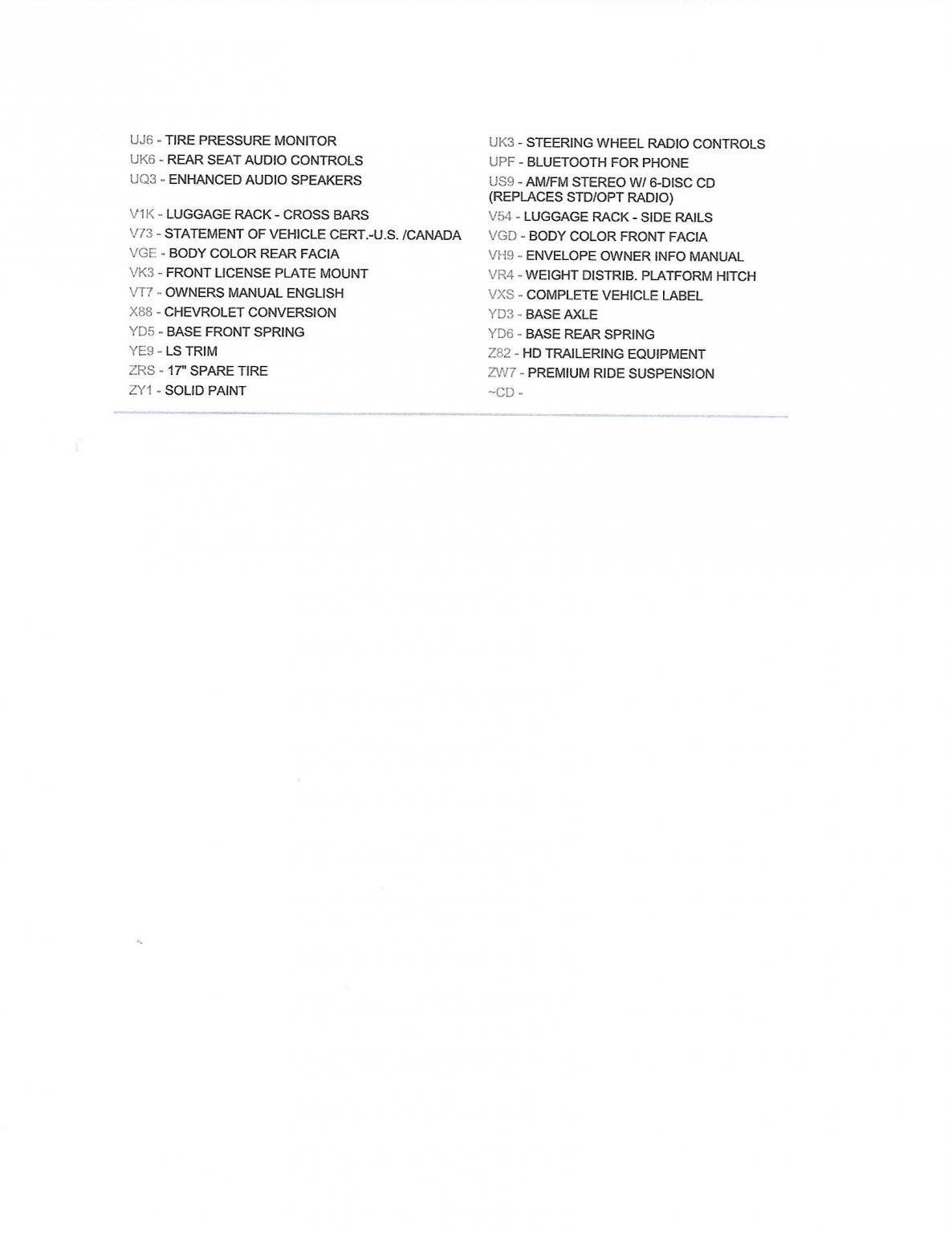

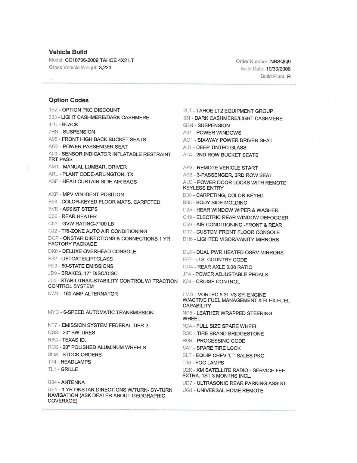

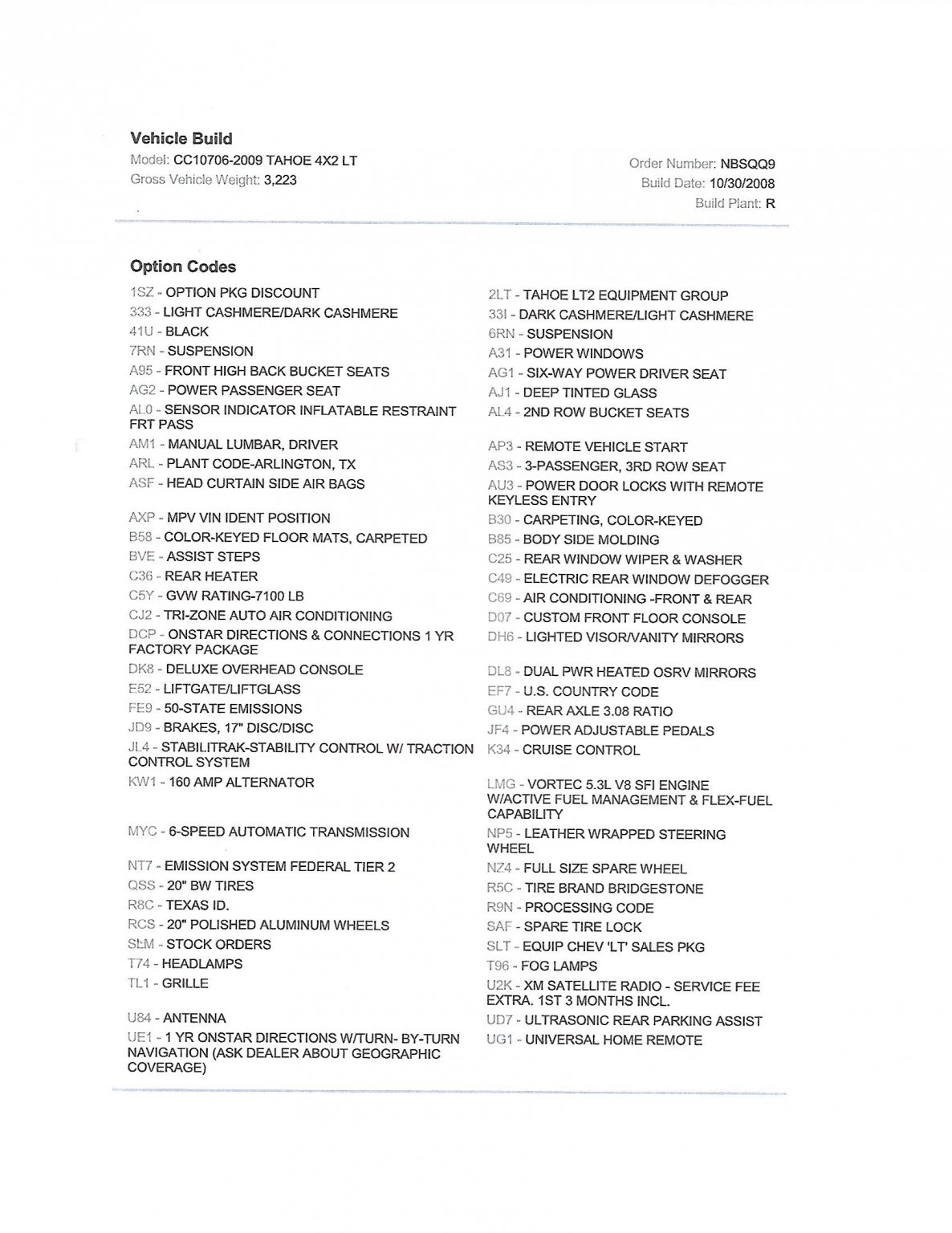

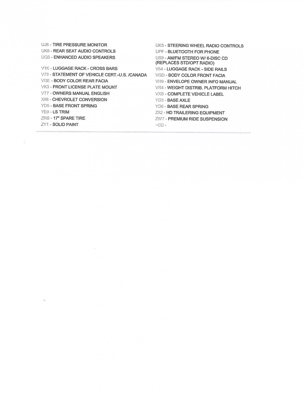

How do you guys get the build sheets to show up as an image. Mine came as a PDF
