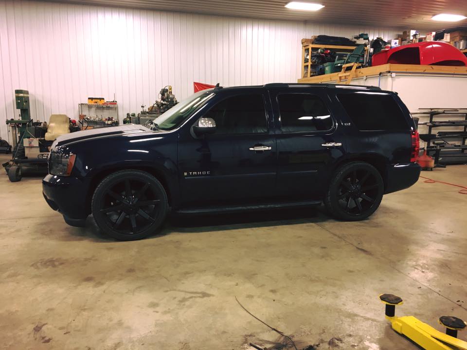

Just finished up lowering the Tahoe last night. Final measurements ended up 2.75'' front/ 4.5'' rear
2'' Drop strut ring on the front (ended up dropping more then 2''), TBSS Air bags in the rear. Set up @ 65psi.
305/35/24, but just ordered 295/35. tahoe.jpg

Looks good!

Thats a fine looking ride you have there.... Here on the east coast the amount of snow we get might make that inefficient.
I love it though..

Very nice. Good call on the 295 tires. I have 305 on mine I was 3" front 5" rear and it was rub city on medium size bumps and tight turns in parking lots.
