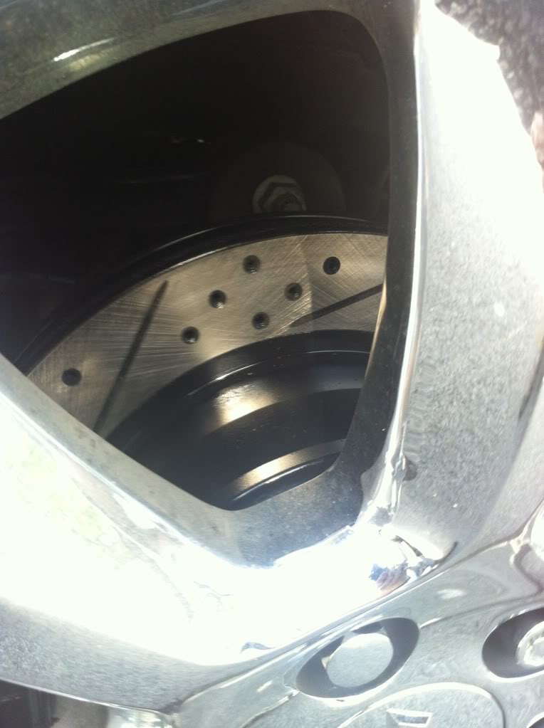

Literally just finished this... r1 Concepts rotors and posi quiet pads.
