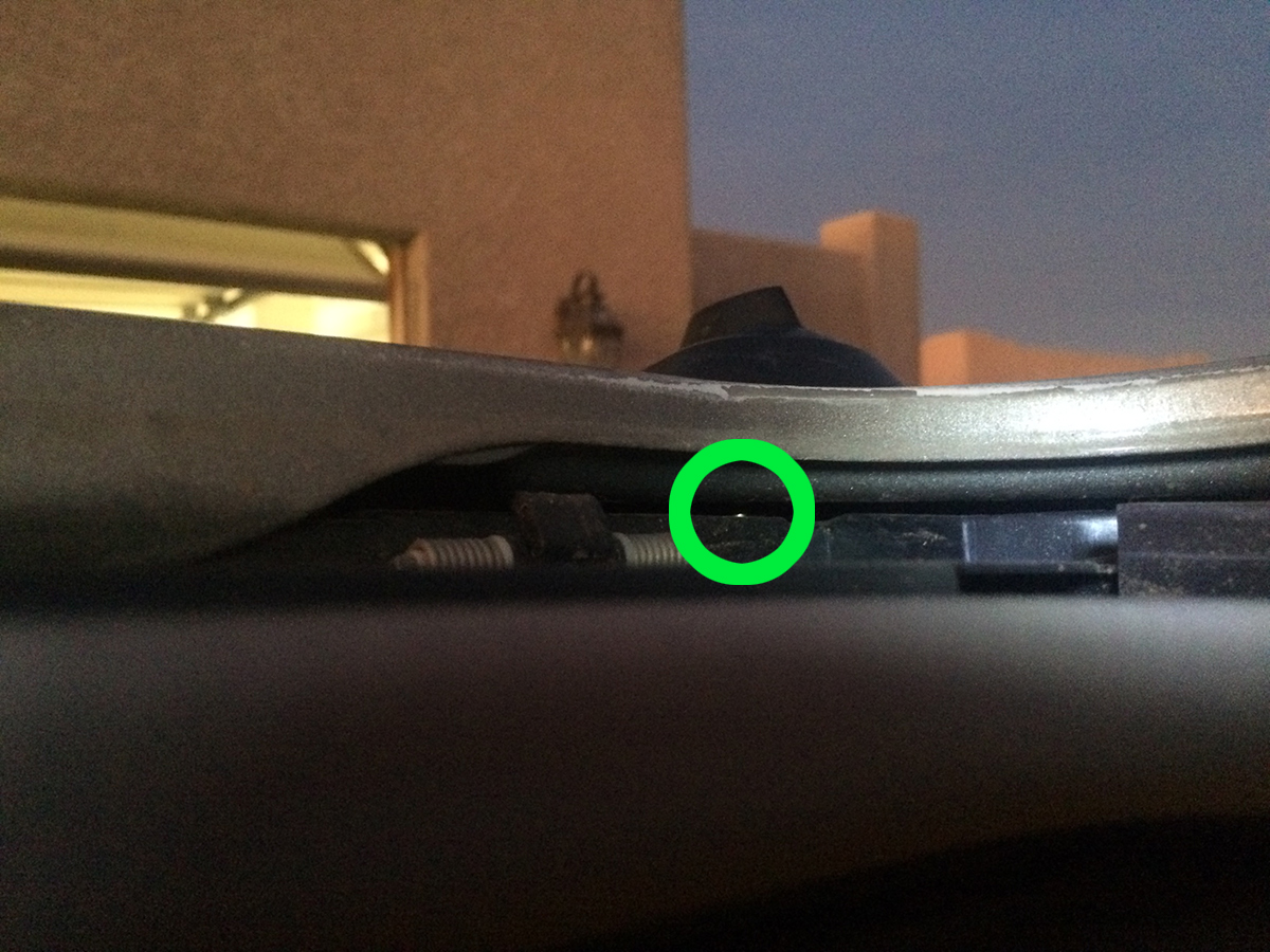

that night i opened my sunroof and tried to see if i could do anything without pulling the headliner. (nope!)
the little shine you see is the unaccessible nut on the right antenna
i spent more time debating and whining about it than it took to get them off.

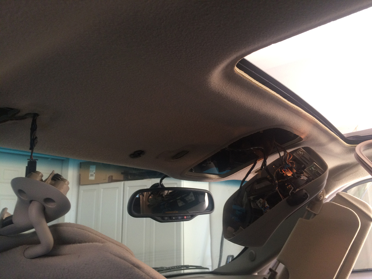

(Using a T-10 Torx for almost every screw i show you)
3 screws on the left, 1 on the right to drop the Left sun visor
i thought the overhead console would be a pain. not at all. One screw near the windshield in the center front and then it's just a nice firm pull south to release all the plastic clips that hold it in.
(i let all this stuff just dangle by the way)

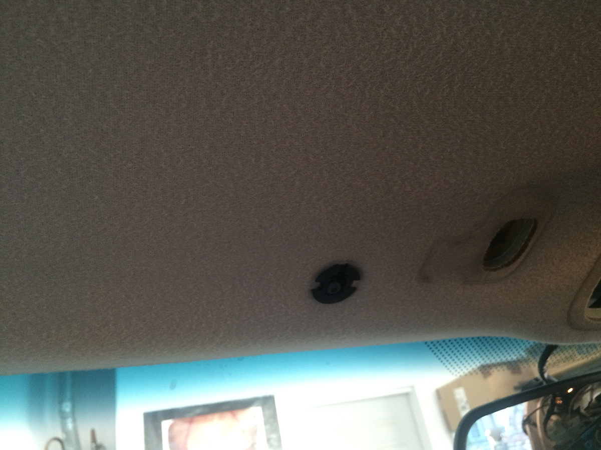

on the drivers side under where the visor was, you will see a circle plug, pop it out and there is another screw to take out
same with the passenger visor, 3 on the right, one screw on the left etc..
Pull the grey weatherstrip half off the sunroof and... access is granted!

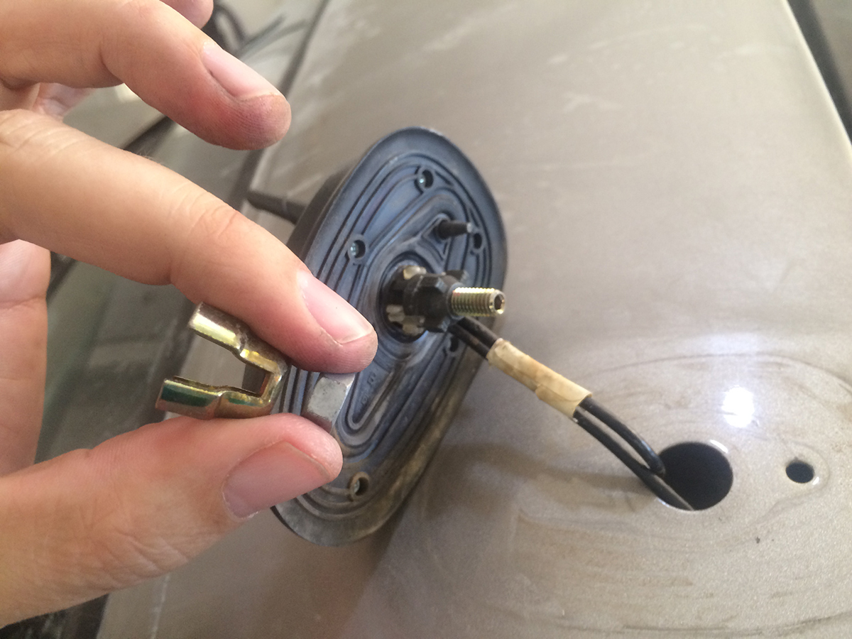

The nut right in the middle holds it all on. I think it was a 10mm but both mine were only finger-tight. So here is looking through from the drivers side and the headliner pulled down a little.
But i used the opening through the sunroof to get my arm in there to do everything on both sides.
once i got the nut off, pulled the lil gold anchor off too. Then i went from the roof and wiggled back and forth as i pulled it up and through. cut the wires and taped them off and pushed them back into the hole
OnStar guts
same for the right side. very similar type of attachment situation.
XM out

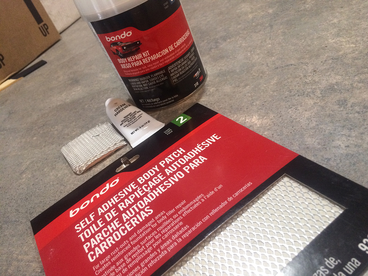

In a perfect world i would cut out little metal circles, use a magnet to hold them in place and then tack weld them in etc..But i don't have a welder here. I used this stuff on my Lexus when i had to fill spoiler holes in my trunk. You basically put it on the inside of your panel and it gives your bondo something to adhere to. Otherwise your bondo is just going to droop into your hole.
So i cut pieces that covered the holes. (it has adhesive on the metal grate)
I scuffed the mtal and degreased it then stuck it on both sides. You can see it if you look close up under that hose
