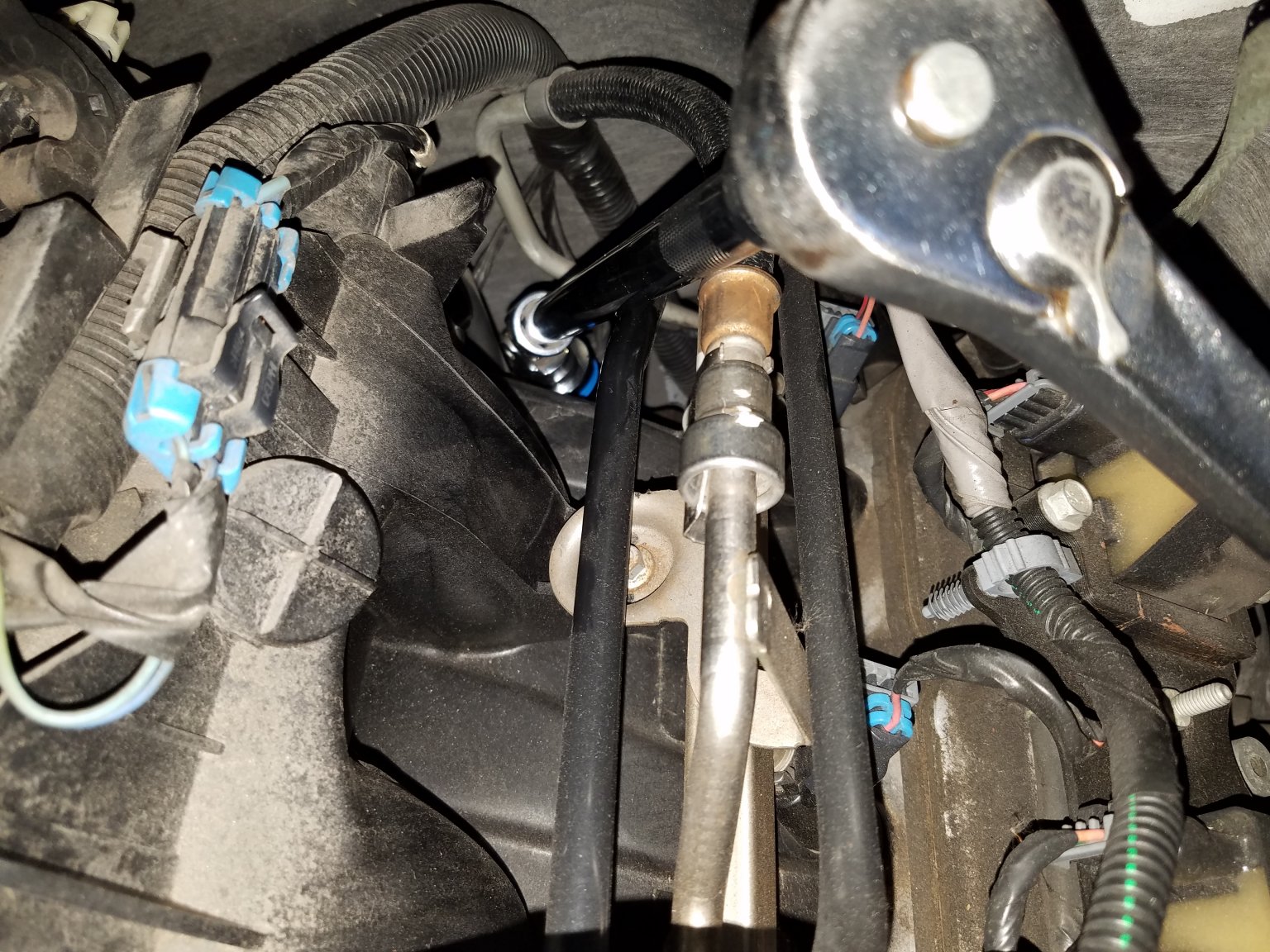

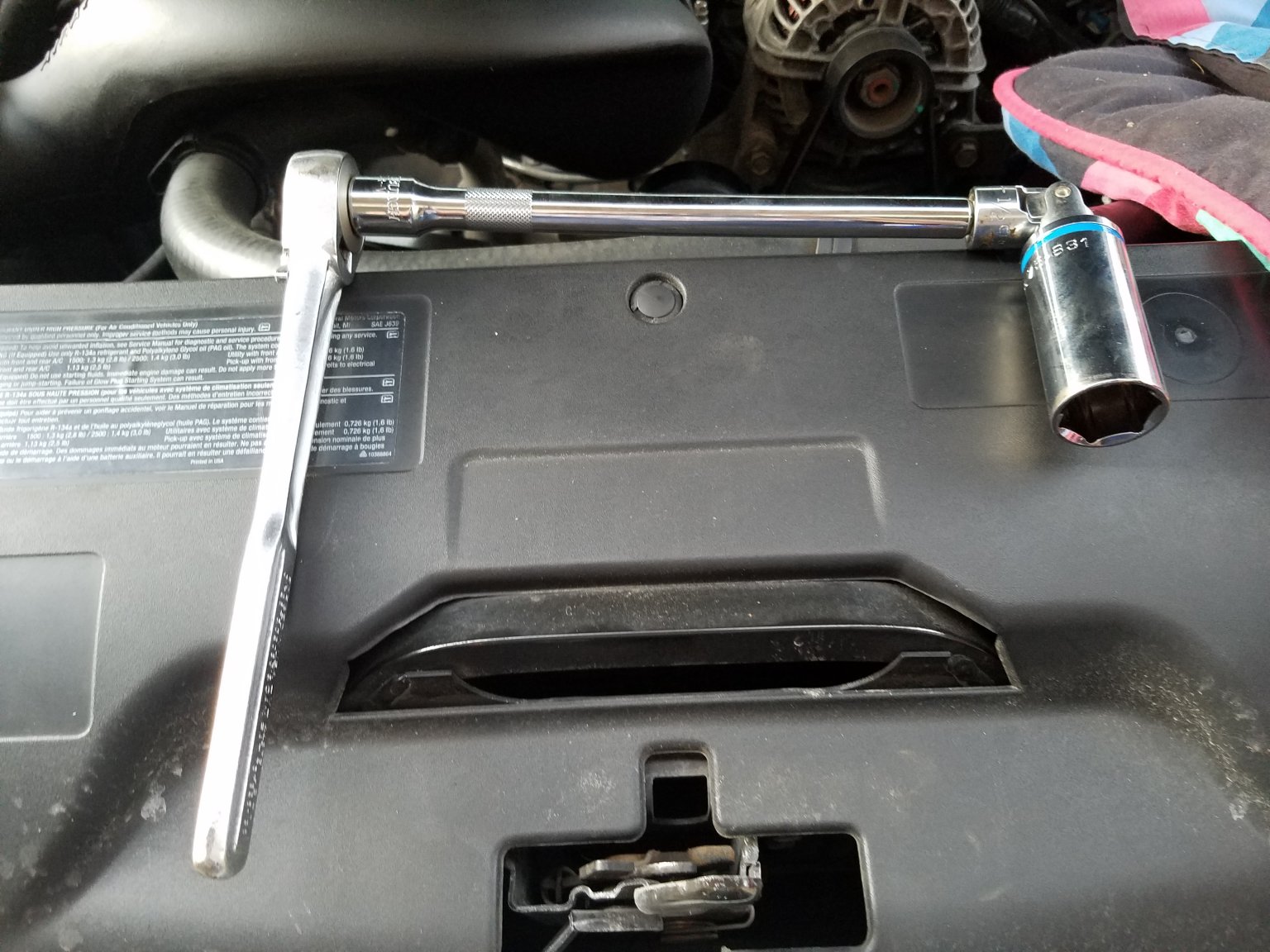

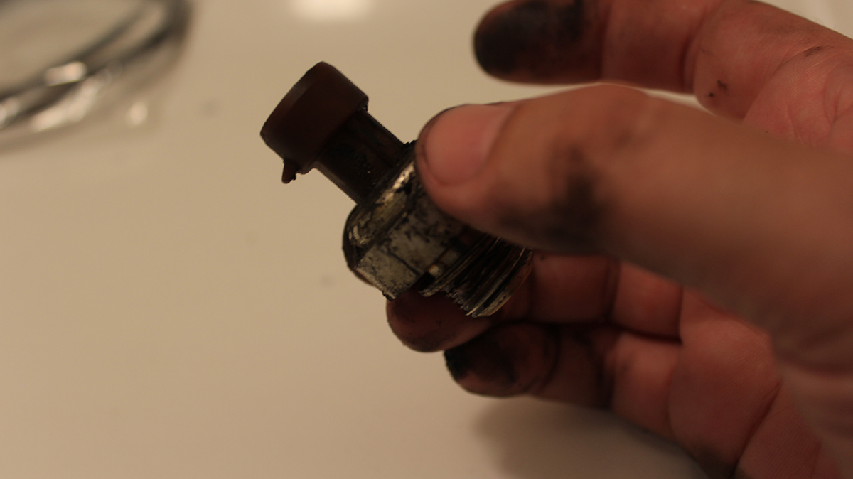

ahh, cool. yeah i saw vids but they were all with the smaller engine. everyone says you need small hands and a mirror or something. I haven't even torn the covers and plastics off to see it.
I can't believe how much work you have done to yours. All the way down to the valve train now? If i got that far, the truck would probably never run again haha

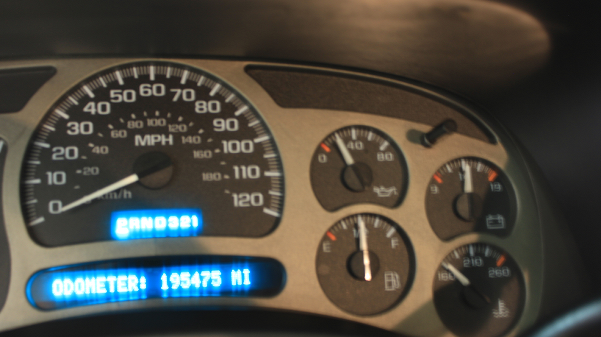

Nice work on the chrome grille color match! It looks sick! I wanna do it to match my silver birch paint, but I know it's a pretty involved and time consuming process. Plus it takes painting skills I just don't have. Lol. So for now I'm stuck with chrome. Anyways looks good man! The nbs Denali is my favorite body style. Clean lines. Yours looks super clean for 195k! I'm subbed for the progress on your truck!
